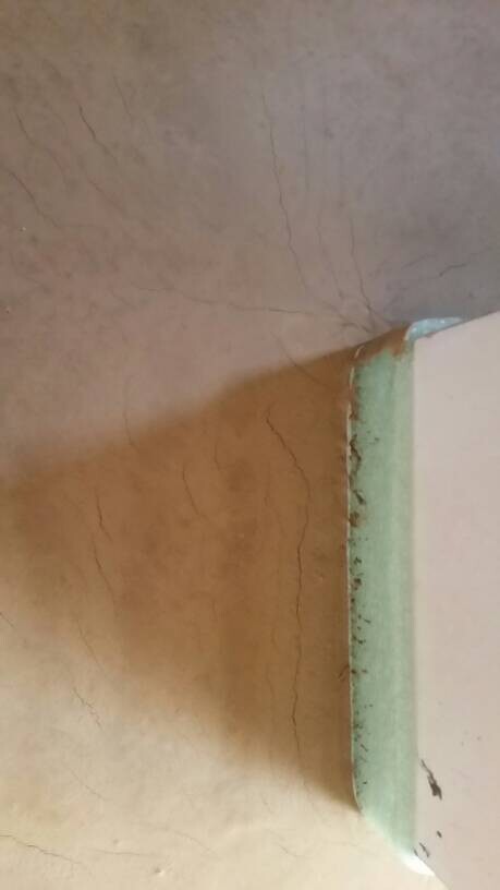

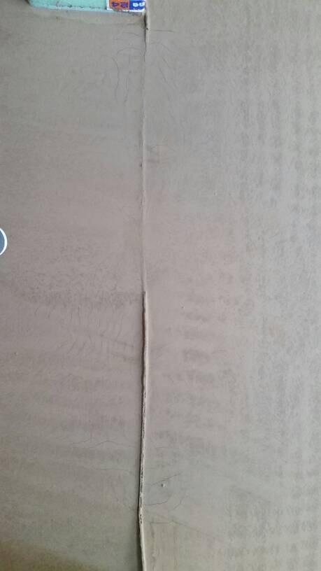

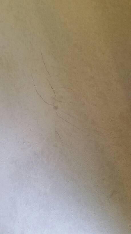

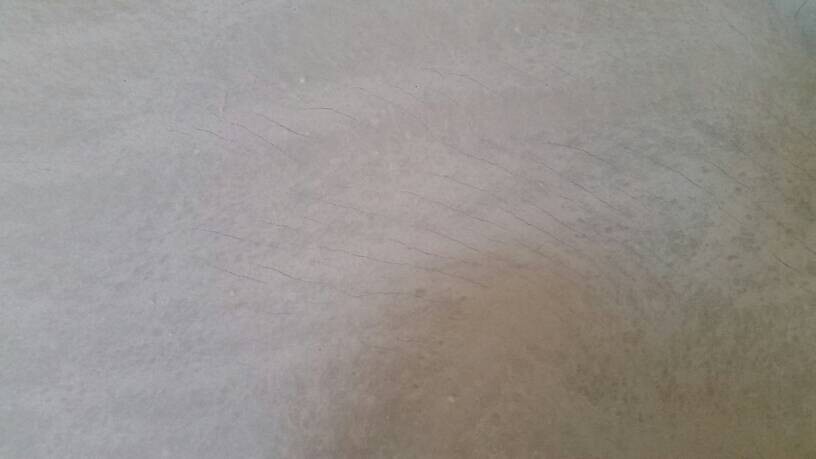

The day before yesterday, on August 24, 2017, I had my CA screed installed.
It has a thickness of 6 cm (2.4 inches) with 16 mm (0.6 inches) underfloor heating which is still turned off. Below that is a 30 cm (12 inches) XPS insulation layer, then the slab. Part of the house has a basement. The house is an older building.
Yesterday, I checked again and noticed that cracks have formed everywhere. Are these normal at the beginning?
Wand mit Rissen und grünem Isolierstreifen an der Kante, Baufehler sichtbar.
Nahaufnahme einer Kartonverpackung mit Falzlinie und Kante
Nahaufnahme einer grauen Betonoberfläche mit feinen Rissen.
Rissige Innenwand mit Putzrissen, Hinweis auf Baumängel
Yilmaz26 Aug 2017 21:13
Hello, such cracks are not normal!
Did the screed get exposed to too much draft?
Please contact the screed installer to determine the cause.
saar2and27 Aug 2017 17:08
No, there is no ventilation.
Yes, I will do that tomorrow.
From conversations, I gathered that the mixing plant has introduced a new screed mixture.
