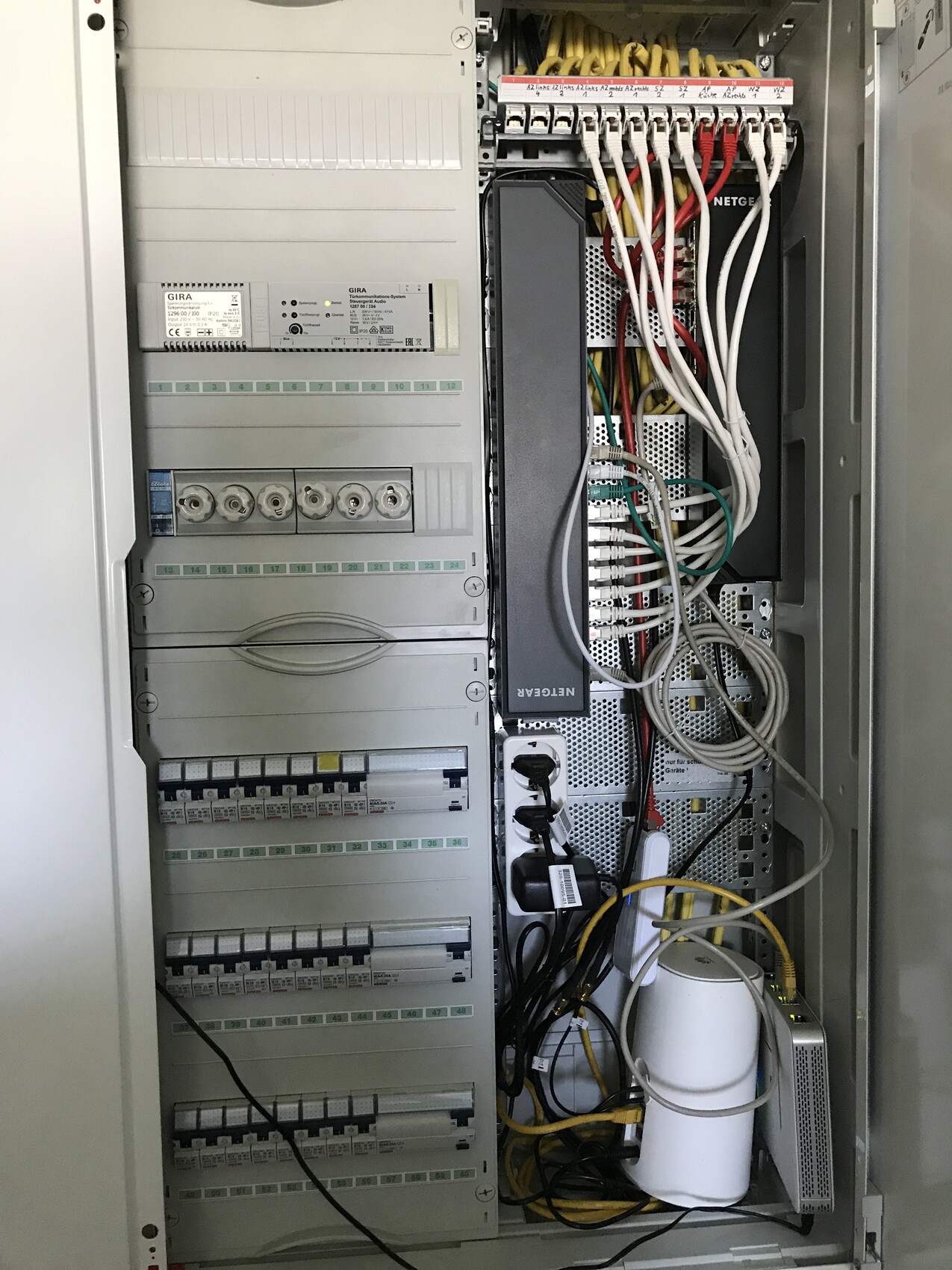

Here is an example to give you an idea of how much you can fit. The photo shows a cabinet from ABB. The media panel is smaller compared to the one from Hager.
Included:
My NAS and RPi units had to be installed elsewhere.
Included:
- 12-port patch panel
- 12-port GbE switch (fanless)
- 9-port PoE switch (fanless)
- Ubiquiti CloudKey
- Ubiquiti USG
- LTE modem
- Power distributor ..
