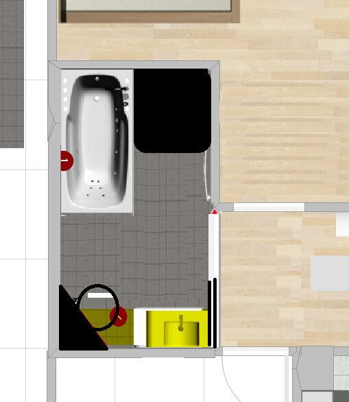

Bathroom floor plan with bathtub, washbasin and toilet in 2D layout

I still don’t see a toilet in the main bathroom?? Leave the bathtub, at the top of the plan a large walk-in shower with a 100cm (40 inch) glass wall, then a large double vanity, and definitely a toilet. Consider seamless alternatives!

Floor plan of a bathroom from above: Bathtub on the left, yellow washbasin at the bottom, gray tiles, door on the right.
With a sliding door to the bathroom (if the wall is not load-bearing), toilet, bathtub, and shower. The washbasin can be moved slightly to the corner, which would create more space between it and the toilet. Instead of having both a bathtub and a shower, a large corner bathtub could also work.

Scout schrieb:
With a sliding door to the bathroom (if it’s not a load-bearing wall), toilet, bathtub, and shower. The sink can be moved to the corner, which creates more space between it and the toilet. Instead of both a bathtub and shower, a large corner bathtub would also work.
If you like something like that, keep in mind the room won’t feel bigger—it will remain cramped and tight. It’s better to skip the bathtub and create a large, open shower area. Consider how often you’ve actually used the bathtub in the last three months and then ask yourself if it’s really necessary. Just because you can somehow squeeze it in around the corner doesn’t mean it’s attractive or practical.
With only 5m² (54 sq ft), compromises have to be made.
Scout
21 Apr 2020 11:27
Basically, I agree with you. But we were talking about children here (one and three years old). In this case, a bathtub is definitely very practical.
