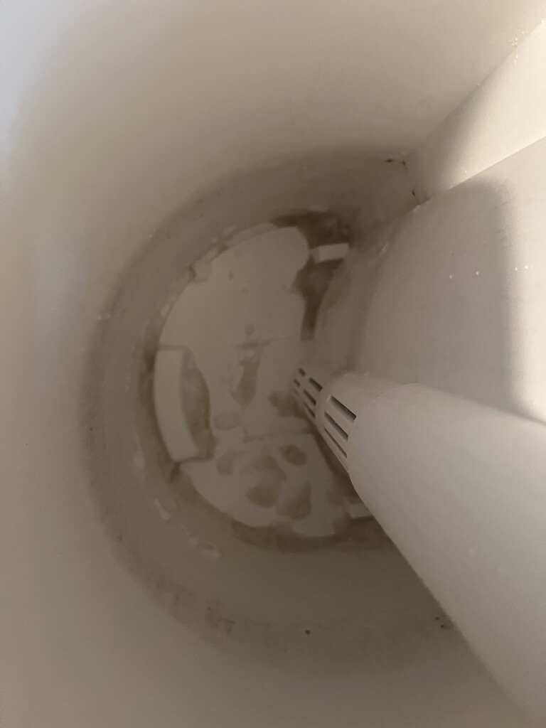

Hello, in our recently purchased house, the tap water tastes musty/chlorine-like! I started investigating the cause and it seems to be due to the Grünbeck water softener system. As soon as water from the softener is mixed in, the water no longer tastes normal! I have read in various forums that this problem occurs quite often with these systems, and I wanted to ask if anyone here has a solution for this issue? I tried temporarily deactivating the chlorine cell, as I read this might help, but it didn’t solve the problem. Tomorrow, I plan to disconnect the system, remove the salt, and clean everything! I would also like to disinfect the system if possible. If yes, what should I use? If nothing helps, it will be removed!
Applefan
9 Oct 2022 18:15
We have hard water in this area, but I still drink tap water, and it has to taste good. If it tastes like an aquarium, I’m not interested! Today, I completely emptied the brine tank. At the very bottom, the dissolved salt was brownish, which might be the source of the problem. It also smelled similar to the water. I would now like to clean the resin using Resi Clean. Do I just need to pour the cleaner directly into the bottom of the brine tank and then add the salt on top?
PS: I’ve attached a picture showing how the dissolved salt looked at the bottom!

Patricck9 Oct 2022 18:20
Applefan schrieb:
We have hard water here in the area, but I do drink tap water, and it needs to taste good—if it tastes like an aquarium, I’m not interested! Today I completely emptied the brine tank; at the very bottom, the dissolved salt was brownish, which might be the source of the problem. It definitely smelled similar to the water! I would now like to clean the resin with Resi Clean. Do I just pour the product at the very bottom of the brine tank and then add the salt on top?
PS: I attached a picture showing how the dissolved salt looked at the bottom!
Yuck...
If the system looks like that, it's no surprise the water tastes musty, not to mention that the ion exchanger probably doesn’t look any better.
But the user shouldn’t be dealing with this; it’s a job for the service technician (unless they just scrap the whole thing).
At Greenbeck, the service costs about 270 euros, which is quite affordable.

Applefan
9 Oct 2022 18:34
Patricck schrieb:
If the system looks like this, it’s no wonder the water tastes musty, aside from the fact that the ion exchanger probably doesn’t look much better.
I agree. I’ve only owned the house for three weeks. I’m going to thoroughly clean everything now. I saw that Grünbeck also offers a maintenance kit with seals and so on, which I will replace as well! Once it’s running cleanly, I’ll keep it in place and might also send water samples to a laboratory—better safe than sorry!
Patricck9 Oct 2022 20:39
Applefan schrieb:
I agree, I have only owned the house for 3 weeks. I’m going to clean everything thoroughly now. I saw that Grünbeck also offers a maintenance kit with seals and such, which I will replace completely! If everything runs smoothly after that, I’ll keep it in place and might even send water samples to a lab, better safe than sorry!
It’s best to have the factory service handle it, there are things I personally avoid touching because I’m not familiar with them.
