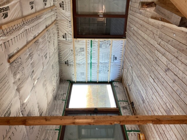

Chris117We want to renovate our stilt house located on the water and are looking for the most practical solution for the floor construction.
The starting point is a 40mm (1.6 inch) thick ship deck made of larch boards with about 5mm (0.2 inch) wide gaps, through which you can currently see the water below. The distance to the water surface is about 1.20m (3 ft 11 in).
Criteria: The new floor construction above the existing ship deck may be a maximum of 40mm (1.6 inch) thick.
Sealing against rising moisture from the water and choosing the right materials are essential!
Our desired concept or idea for the build-up is as follows:
1) Bitumen membrane as protection against rising moisture above the existing ship deck
2) Substructure of OSB boards, 19mm (0.75 inch) thick, tongue-and-groove, glued
3) Impact sound insulation with 3mm (0.1 inch) cork roll mats
4) Finished parquet flooring, 16mm (0.6 inch) oak planks in a 3-layer construction as the final floor
Can this floor construction work without the OSB board starting to crumble due to possible rising moisture or the parquet floor breaking down?
… or would it be better to lay a solid spruce ship deck floating on, for example, Styrodur?
Who has experience with building on the water? I look forward to your thoughts!
Many thanks!

knalltüte31 Dec 2020 01:06What comes to mind spontaneously looking at the picture: Is this legally approved for building? You don’t want to have to dismantle everything in the end 😕
