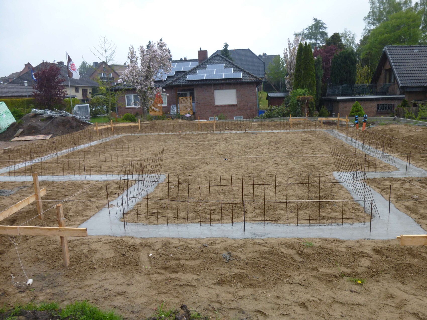

Hello friends of house building,
Until now, I always assumed that you insulate a slab foundation using formwork. Simply placing a shell of XPS insulation and then pouring the slab. Of course, that’s a very simplified explanation.
Our construction manager now suggests a frost skirt. This means that the masonry and the slab will be insulated with x cm of insulation material, and the strip footing will receive 5 cm (2 inches) of insulation. The area below the slab will not be insulated because the strip footing with the frost skirt makes it unnecessary, AND insulation of walls, roof, etc., provides more benefit than insulating the slab. It could be insulated, but it would add more cost.
What do you think? We do need to keep an eye on costs, and if it is more than just a nice-to-have, we have no problem with it, but I must admit that we have little information (and no experience at all) on this.
