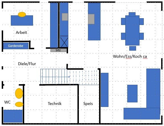

Maulwurfbau15 Aug 2023 13:38I did some more playing around, starting with the ground floor only. Conceptually, it could combine quite a few of the features mentioned here, don’t you think?
I tried to roughly draw it to scale. One box equals 1 meter (3.3 feet).
The window by the sofa is intended to be non-floor-to-ceiling and fixed glazing. The large one at the dining area would be part of a unit that can be opened. The same goes for the one in the kitchen. The terrace could be a narrow strip along the south side, accessible from the kitchen, wrapping around to the large terrace on the west side, facing the garden.
It’s just an idea—not to justify a straight staircase, but to see if more can fit on a similar footprint with a straight staircase.
hanghaus202315 Aug 2023 14:06Draw it again with somewhat realistic exterior walls. Then there will be issues with the stairs and access to the utility room.
Regarding the missing wall between the pantry and the staircase, you could come up with a solution if the upper floor layout works out 😉
However, I have some reservations about this staircase (as drawn and considering its requirements), which seems to be a straight, must-have staircase.
Otherwise, I would try furnishing the space realistically. After all, there are several things you want to include. This includes the possibility of storing items in the freezer (storage space), a proper wardrobe cabinet with a depth of 60cm (24 inches) (next to the coat rack and jackets), shoe storage for four people, a guest bed, and possibly also a 60cm (24 inches) cabinet in the office.
But first, the upper floor…
