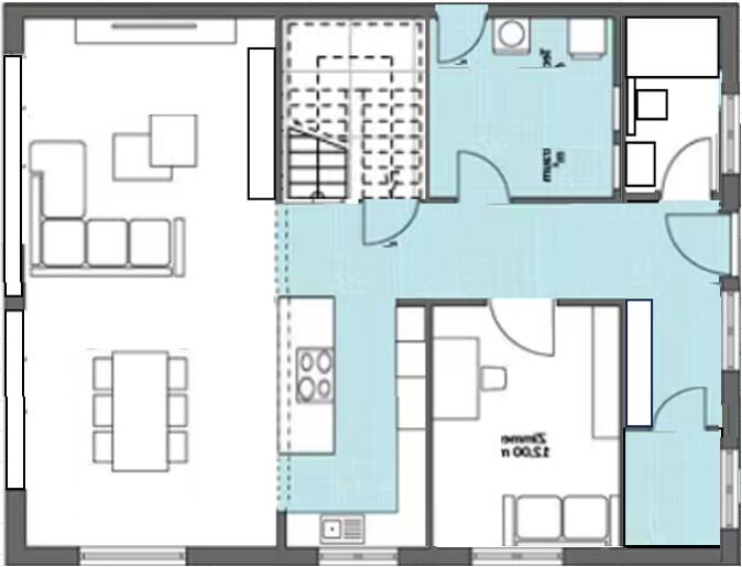

Laundry room on the upper floor. They want to do laundry where it is generated and where it must be returned clean. Anything else is a hassle, at least for us.
Who designed the plan: Architect
Everything we provided as basic information and what our daily life requires has been implemented.
We like the clear lines/structure.
The open space in the hallway.
The connection/proximity of all rooms on ground and upper floors that need water/sewage. So no funny business with the bathroom upstairs in one corner and the utility room diagonally opposite on the ground floor. Personally, I like that.
No bay windows or other awkward extensions.
Laundry room upstairs where the washer and dryer are planned.
What don’t you like? Why?
The living room might be a bit too exposed for us. It could also be a cozy nook with TV without direct view of the kitchen. Cooking and eating together openly is liked; the living room could be a bit more separate. Currently, the floor plan shows it like a narrow, rather shadowy corner.
The somewhat narrow bedroom upstairs is not a dealbreaker but not 100% pleasing.

The design turned out this way because the architect implemented our wishes and requirements almost 1:1. This preliminary layout resulted in this first version.
What do you consider particularly good or bad?
See what we like and what not. We don’t find anything particularly bad. Rather, not entirely optimal.
Position garage flush with house or set back?
43.5 sqm (468 sq ft) + 4 sqm (43 sq ft) pantry sufficient as “all-purpose room”?
Same floor plan possibly mirrored? Then office on south side, sun all day, blinds always down. Same issue upstairs with bedroom in summer at least. Entrance farther from parking space.
The building method will be timber frame construction with a local timber builder.
This is a first sketch after clarifying needs/wishes with the architect.

11ant13 Aug 2023 12:10
Edit: What does this mean for the next steps?
A. "Go back" to keep the entrance on the gable end
B. Keep the house narrow, accepting an inconvenient staircase position
C. Maybe consider a brick house (with clay plaster inside)?

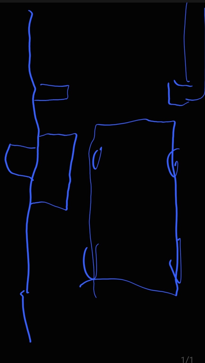

Well, those are some jokers. They added an extra building recess on the side to increase the driveway width because of the platform, even though the entrance is on the gable side.
I tried to make a sketch again on my phone. What does “Bauchweh” (literally “stomach ache”) mean here? It was given as a note that due to the tightness of the plot and the building gap, one should keep in mind that the entrance will require a step and that a very narrow situation might occur at the entrance if you’re not careful. In other words, the car would be directly in front of the platform or would have to drive over it to reach the garage. That’s all.

Well, as I said, this is a draft, not an approved version. I am currently reconsidering all suggestions and comments.
Regarding the width: the house can be a maximum of 10 meters (33 feet) wide; the current plan is about 9.15 meters (30 feet). So, it can’t be much wider. Also, it doesn’t hurt to keep a certain proportionality for the building’s shape. That’s why the plan is as it is concerning length, width, and roof pitch. The staircase is not fixed for me yet.
As for building with wood, it’s a bit of a tricky topic. Let me put it this way: if I go into a car dealership wanting a two-seater, it doesn’t make sense to be persuaded to buy a station wagon. Honestly, I still don’t understand why building in stone would be better. I don’t see any dealbreakers for a wooden house.
The only issue is that the plan is not yet where it should or could be.
