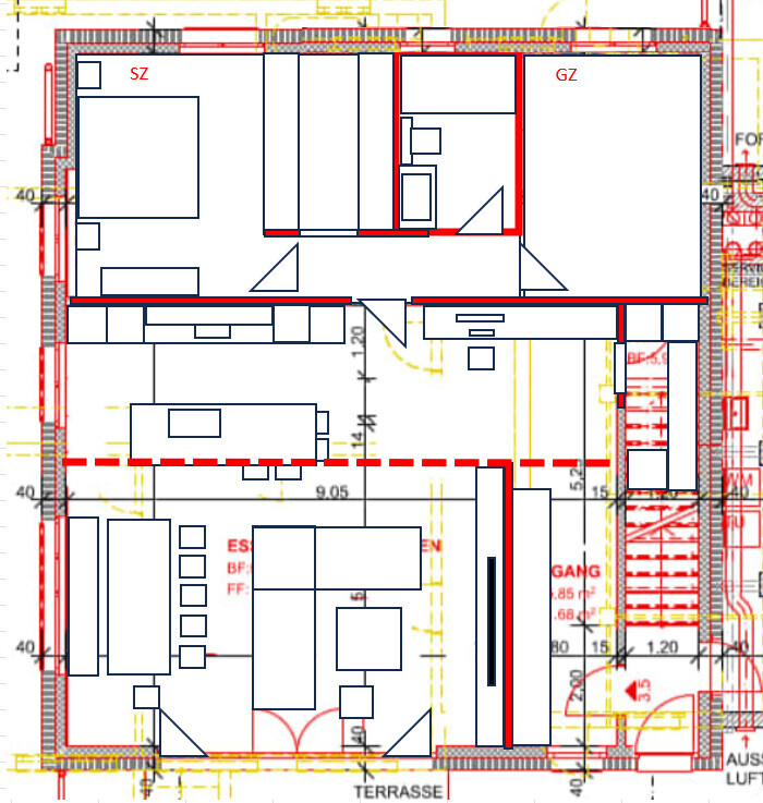

hanghaus20231 Apr 2025 16:15Do you mean something like this?
The dashed line indicates a beam that allows you to omit the support column. Upstairs, everything would be drywall construction. The ceiling area in the kitchen might be lowered to accommodate ventilation ducts.
The door to the sleeping area could also be left out, or replaced with a sliding door that can be closed when needed.
Will this be a solid (masonry) house?
