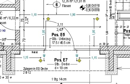

Our ground floor is currently being built, and while going over the plans in detail, one thing completely slipped past us: the width of the house entrance area – it’s currently 3.11 meters (10 ft 2 in).
We actually like the idea of a spacious entrance, and many houses, in our opinion, tend to make that area too small. But over 3 meters (10 ft) is quite a large space that needs to be filled appropriately.
On Friday, we’re visiting a trusted carpenter to look at examples and get some advice. So far, we were thinking of the classic window-door-window layout without a transom.
However, in my opinion, the windows would look a bit too wide visually, so here’s my question to you: How wide can an entrance door be while still being practical to use? Is 115 cm (45 inches) too wide? We’ve also seen double doors, but somehow that seems a bit too “overdressed,” doesn’t it?
Many thanks in advance for your advice 🙂.
