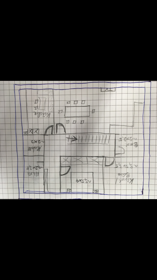

This should work with your exterior dimensions, I think. Unfortunately, my sketch is rotated. Don’t be confused by the numbers inside the rooms; with reasonable wall thicknesses, you’ll definitely need to adjust things a bit.
Edit: Even though it might make the hallway feel more narrow, it could be practical to place the entrance where the storage room is currently shown. The utility room could then extend across the former entrance area, or part of the current hallway could be added to the bedroom.

I think it should fit with your external dimensions. My sketch is a bit rotated, though. Don’t be distracted by the numbers inside the rooms; with reasonable wall thicknesses, things will have to be shifted a bit.
Edit: Even if it makes the hallway look even more like a corridor, it might be a good idea to place the entrance where the storage room is currently shown. Then extend the utility room through the previous entrance, or allocate part of the current hallway to the bedroom.I like that too. The bathroom wouldn’t have a bathtub, but the shower should just fit, right? The bathtub could be added later upstairs. I would still add a door to the driveway from the utility room and connect the storage room with the utility room. The washing machine, sink, and that huge boiler for solar hot water need space. Food can be stored on shelves along the wall.I also like that the kitchen faces south, so you can keep an eye on the kids in the garden.
