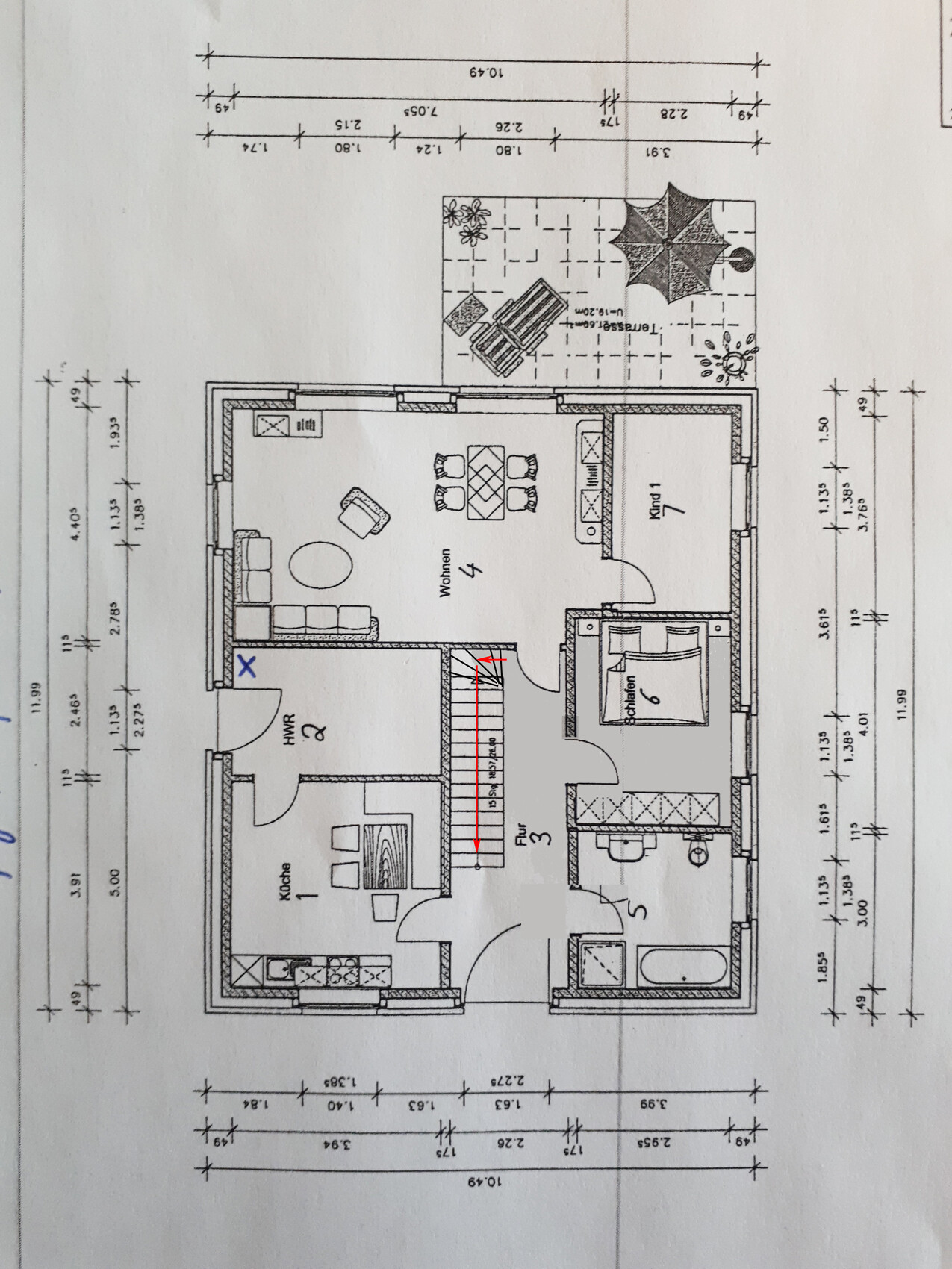

The floor plan is based on a very similar layout seen during a house viewing and is our favorite among all viewings and catalog research. We only adapted it slightly to our needs (removed guest WC and enlarged living room, rotated office).
The floor plan basically fits us, but I would appreciate your opinion to see if any improvements are possible. Note: as mentioned, we want to move the office window to the west so the wall doesn’t look so bare. Driveway on the east, not west. Therefore, the bare wall on the west is where the carport will go up to the utility room door. Alternatively, a window could be added to the living room there and the carport start behind the house. The plot allows this.
My main concern is that we’re not 100% happy with the roof’s east-west orientation; I would prefer a north-south alignment. Do you have ideas on rotating the floor plan 90 degrees while keeping the layout mostly unchanged? Only the kitchen and office could be swapped.
PS: The square meter figures for the hallway may be incorrect; the contractor will finalize after Easter. Correct figures will be approximately: living room 31.79 sqm (342 sq ft), kitchen 15.19 sqm (163 sq ft), utility room 9.87 sqm (106 sq ft), hallway about 19.5 sqm (210 sq ft), office/child room 1 about 8 sqm (86 sq ft), bedroom about 11.8 sqm (127 sq ft), bathroom about 8.5 sqm (91 sq ft)

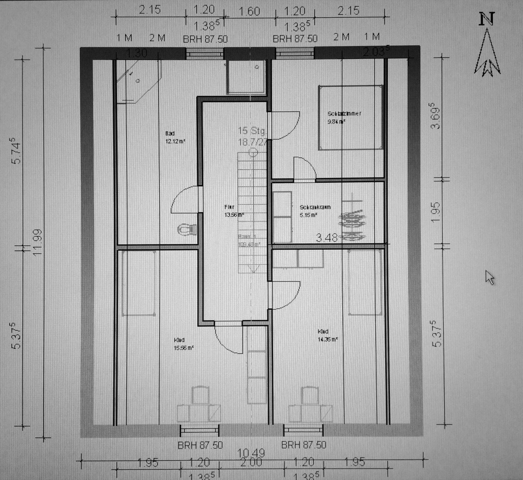

I don’t find the situation unsolvable or the rooms too small, etc. However, the lack of measurements and detailed planning is quite concerning. But keep your spirits up. We’re happy to help. The more challenging the requirements, the more interesting it becomes.
I’m just saying “oak.”

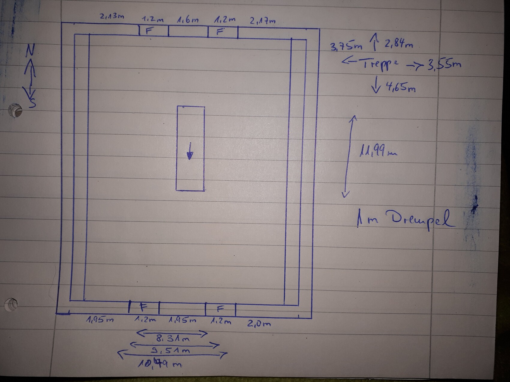

There is one room too many.
The planning for the upper floor should have been done earlier.
The ground floor is already built.

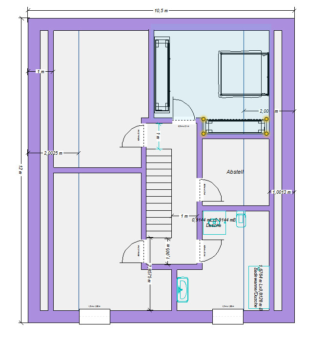

I would plan for 2 children's rooms, 1 bathroom, and 1 storage room upstairs.
Who sleeps where and when will depend on the daily routine with the child/children.
Not every family is the same, not every child is the same.
Master bedroom now on the ground floor.
Where child 1 sleeps will have to be decided.
Maybe the small room could be added to the bedroom?
Or a 140 cm (55 inch) bed with a bedside bed.

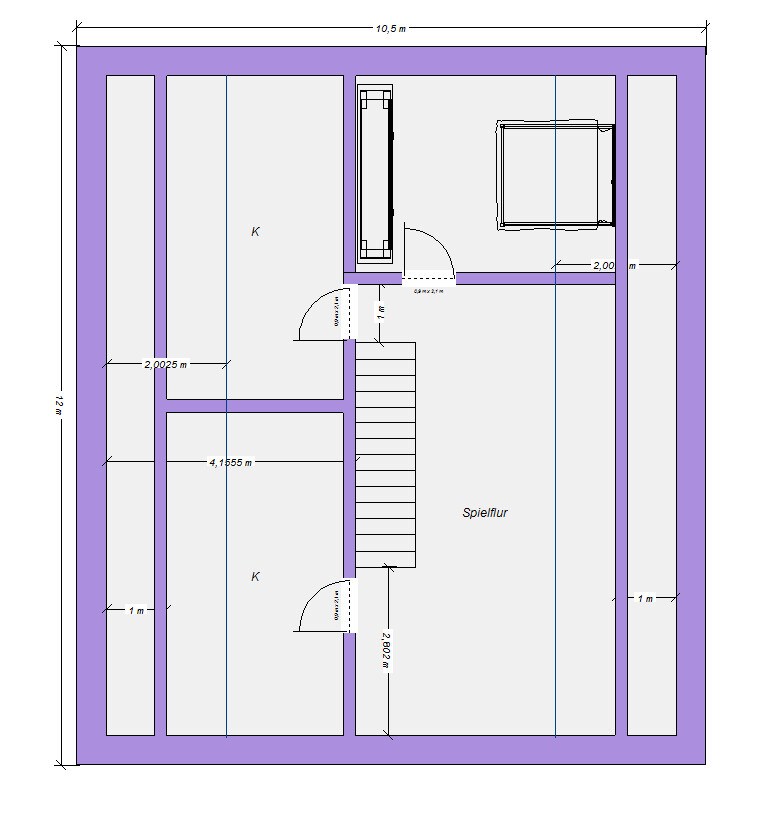

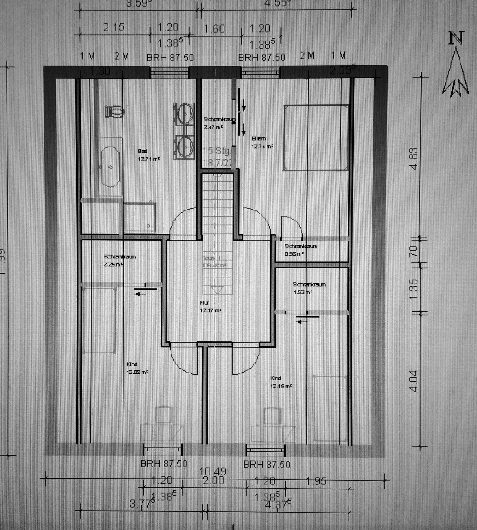

pffreestyler4 Dec 2018 13:32Ok, ok, it’s clear that we need to make some compromises.
Then this floor plan seems to fit best. The 1m (3 feet 3 inches) and 2m (6 feet 6 inches) lines would still need to be shifted slightly outward, giving the rooms a bit more space.
The storage room is removed, and the room on the north side remains flexible and can be used as a bedroom, office, or storage.
In my opinion, the children’s rooms are large enough!?

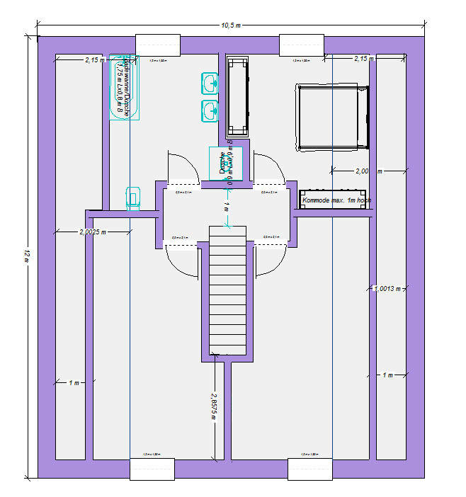

Now then... based on Katja’s designs...
Although I haven’t looked recently, the hallway turned out just as I remember from Katja’s plans
Using the OP’s dimensions
pffreestyler4 Dec 2018 13:59Huh, what do you mean by that?
Man, man, man...
There’s no child yet. And when the extension will actually happen is uncertain.
Once you have moved in, you will be focusing on other things, certainly not on the above-mentioned extension. Then, if all goes well, the first child will be accommodated next to the living room. Even then, there won’t be a real need for the attic conversion – even if you imagine it differently.
So, when eventually you have two kids, they will definitely manage if mom doesn’t live right next door but 5 meters (16 feet) away. Your house won’t be any bigger than that.
The house suffers from too many compromises back and forth... there will always be some kind of compromise somewhere.
