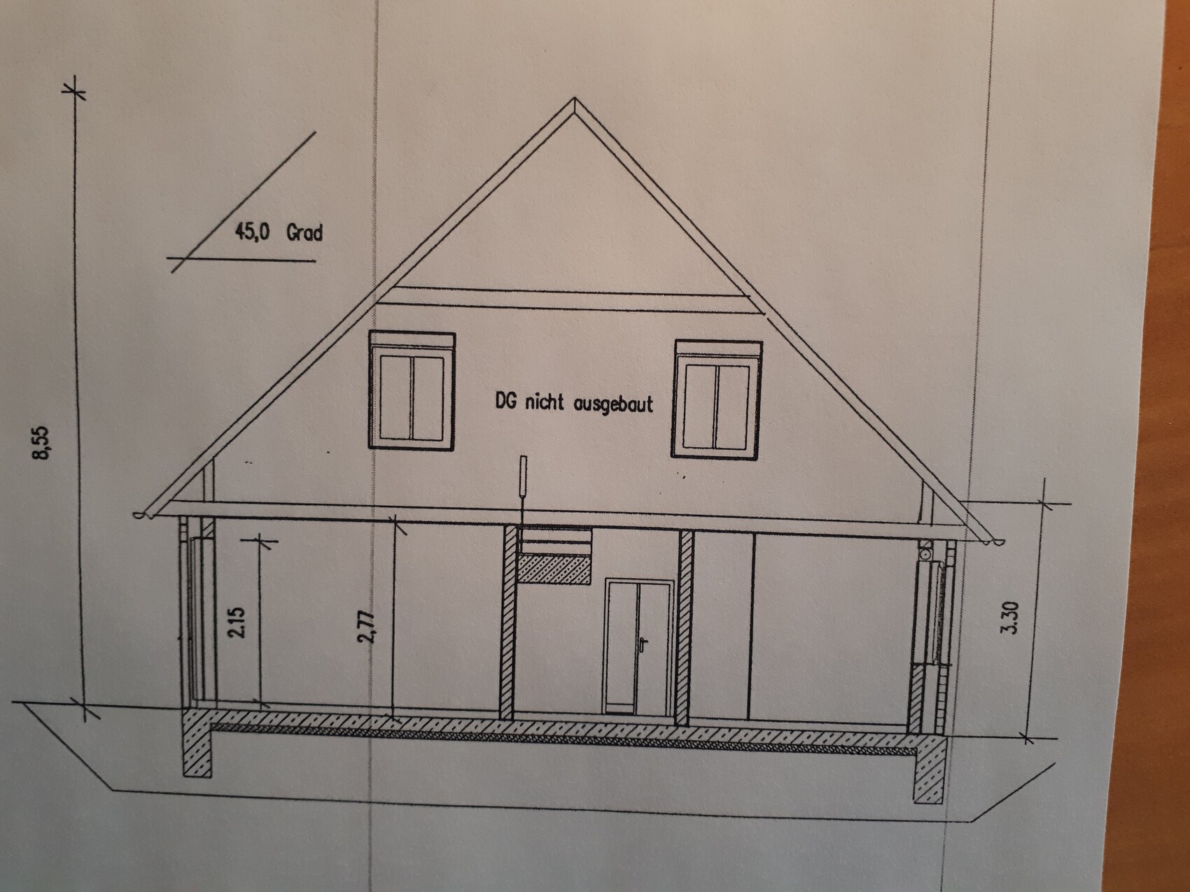

Why measure at all? There are plans for the ground floor, from which you can take the levels, and deviations between planned and actual are generally expected to be in the same range above. So, with the usual caution of not pushing the last five centimeters (two inches), you can carry the ground floor measurements “upward.”

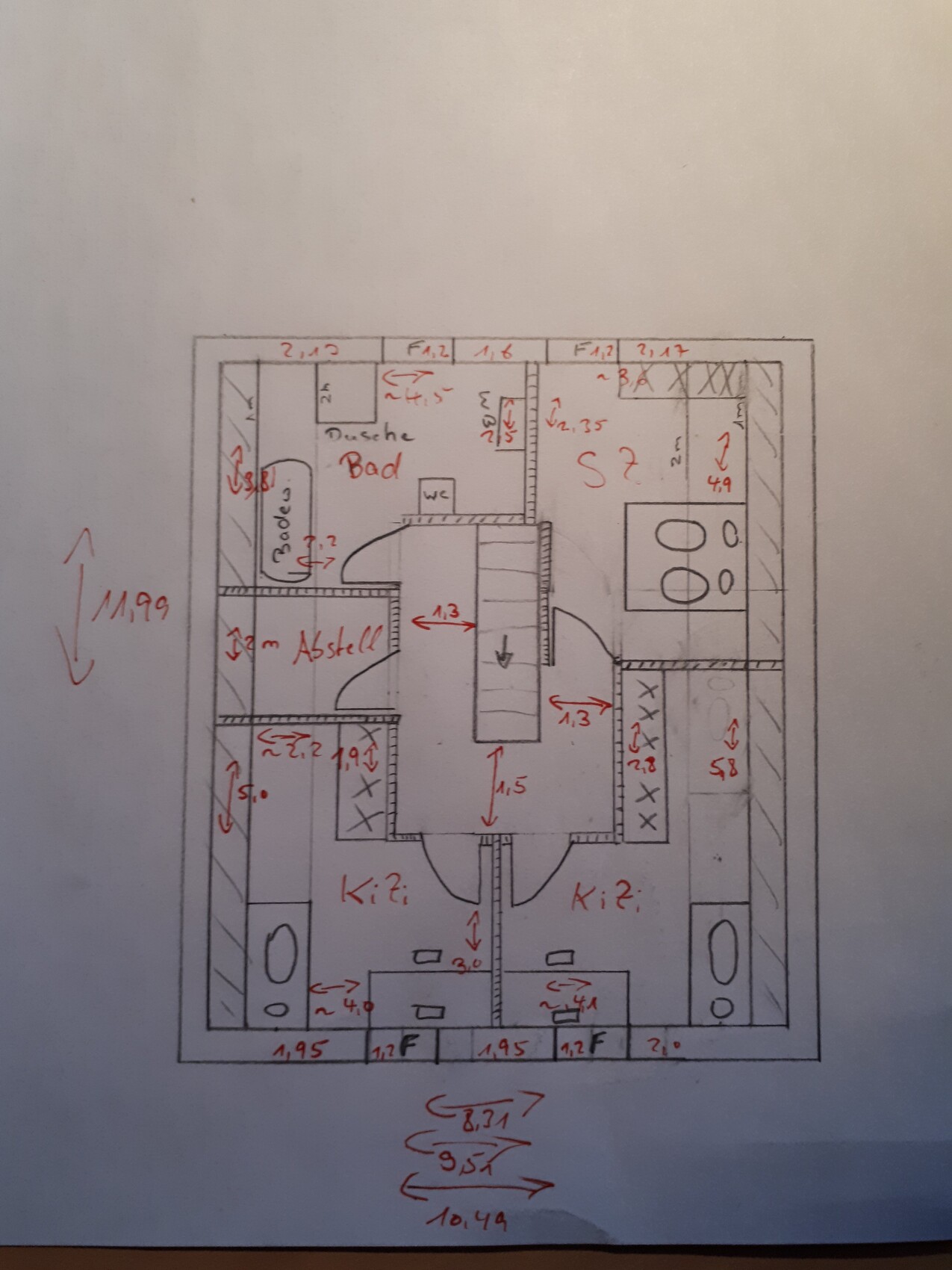

pffreestyler3 Dec 2018 14:32So, the meeting took place on Saturday.
We laid out the possible floor plan using battens. We were advised to make the hallway at the stairwell exit 1.5 m wide (5 feet) and to position the doors so that furniture can be moved in directly, allowing easy maneuvering around the corners. The walls would be 14.5 cm thick (5.7 inches) with 8 cm insulation (3 inches). On the side, a hallway width of 1.3 m (4.3 feet) should be sufficient. A bathtub is not a structural problem.
I tried to sketch it out.
The following questions remain:
1. Is this layout okay for the shower?
2. Is 8 cm insulation (3 inches) enough for a 14.5 cm (5.7 inches) wall? The roof will not be insulated until the attic is finished.
3. Have I made any mistakes? It looks quite consistent to me.

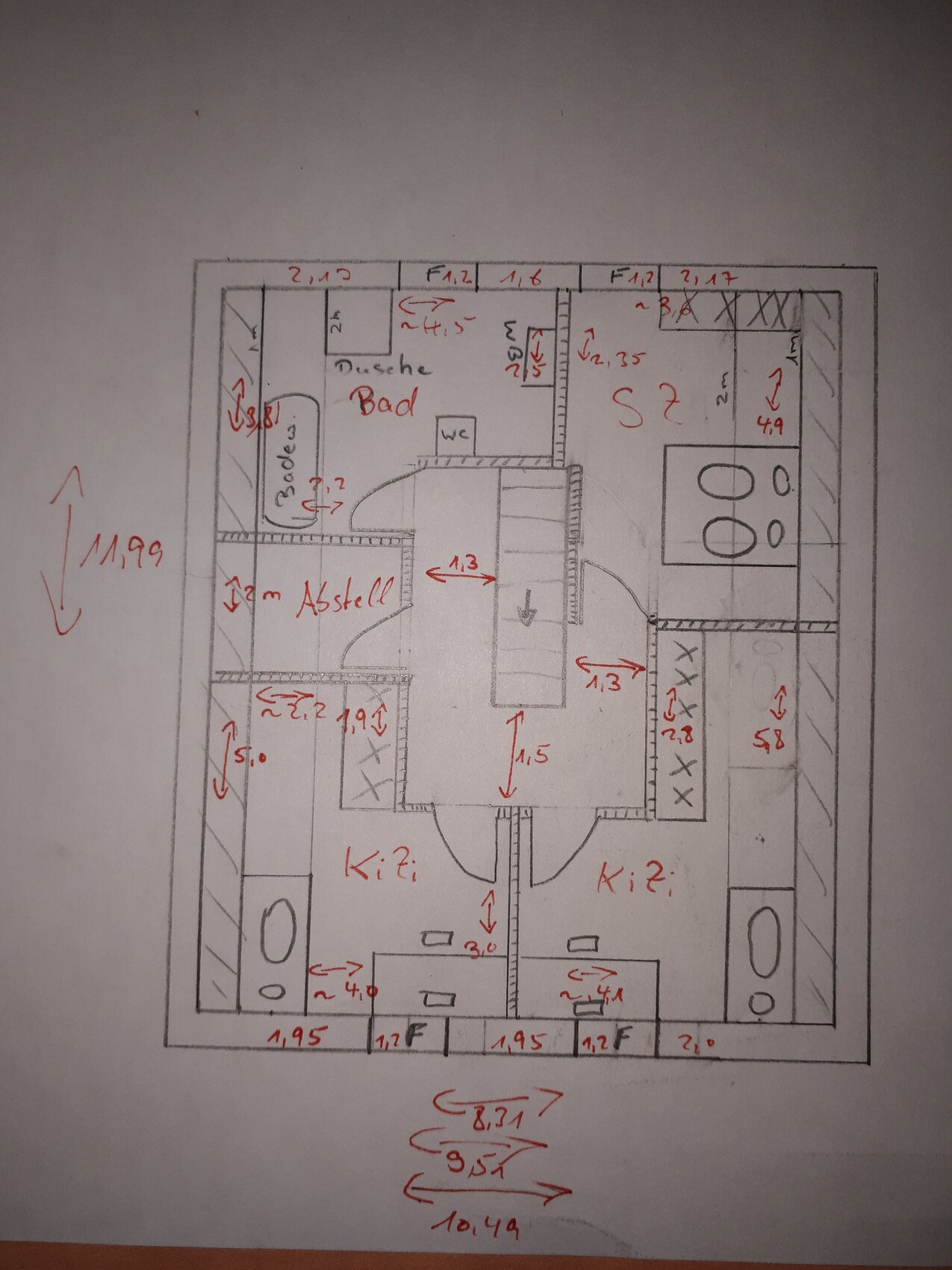

4. It was stated that they are not aware of underfloor heating (gas) working with a dry screed system on wooden joists. The reason given was that wood does not tolerate heat well and tends to "move." I am supposed to contact my plumber again about this. I know that my cousin has underfloor heating (geothermal/collectors) on dry screed. There are special dry screed panels with predefined heating channels. Is there a difference between gas and geothermal in this regard?
Just as a suggestion: in the children's rooms, thanks to the 2-meter (6.5 feet) line, open wardrobes or ones with sliding doors are probably more suitable.
At the moment, no wardrobe other than a custom-made one fits in the bedroom. If possible in the bathroom, I would move the bedroom wall by about 65 cm (26 inches) so that a wardrobe can fit there without blocking the window.
pffreestyler3 Dec 2018 14:52Oops, the bedroom closet layout is quite illogical... but it should be possible to fix this by moving the wall as mentioned, without making the bathroom layout illogical.

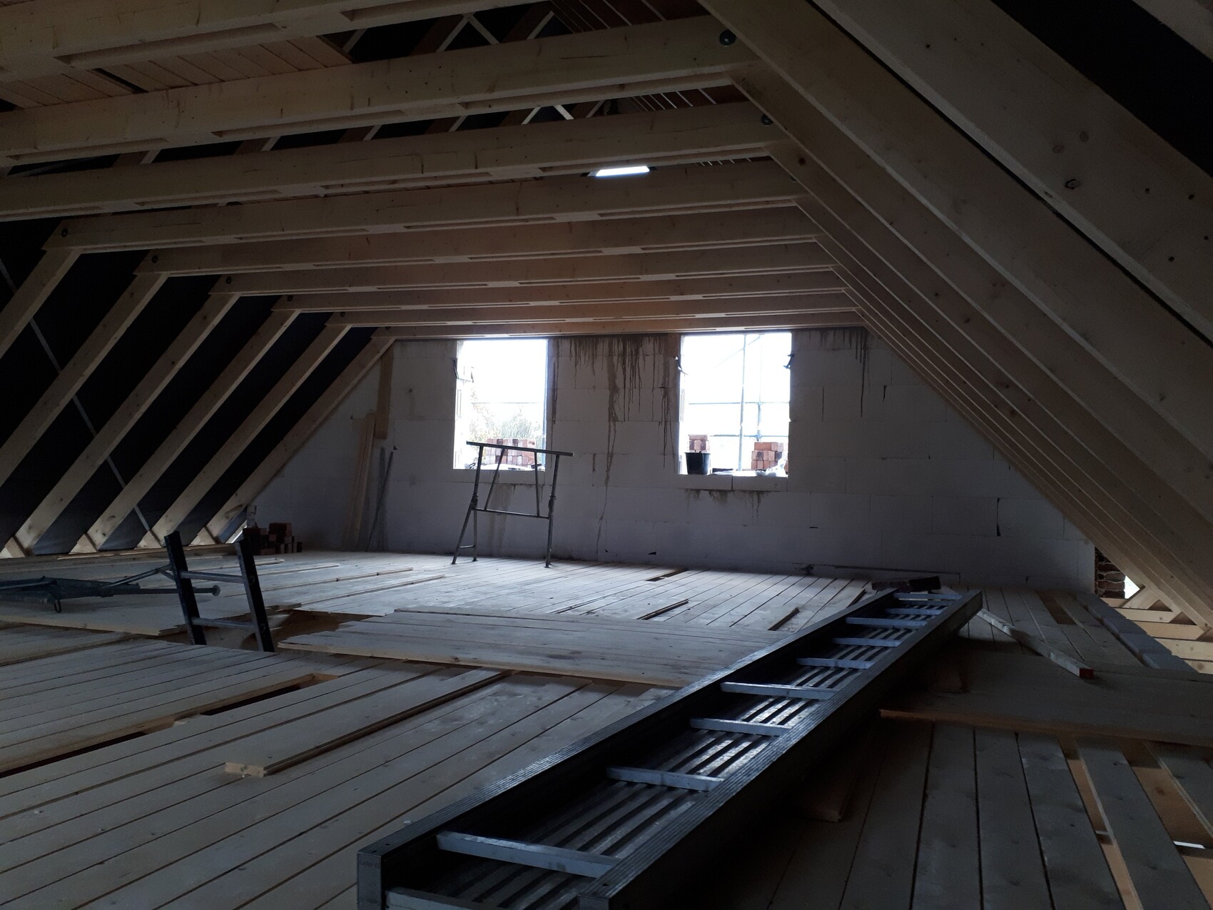

In the children’s rooms, you could swap the desk and the closet, but that would reduce the natural light at the desk. So, either install a roof window later on if you get lucky (it was intentionally built with the wind bracing and perforated tape to allow this without problems) or use closets with sliding doors.
The cabinets will probably need to be custom-made. Although there are now cabinet systems designed to fit under sloped ceilings, these are not cheap either. I would always get a price comparison from a local carpenter who can make something exactly suited to your space. Usually, this isn’t more expensive, but it is often better adapted to individual requirements.
Make the second child's bedroom as small as the first one and add the gained space to the master bedroom. Then, you can have a built-in cabinet on each side of the bed, fitted into the slope.
I would have kept the master bedroom on the ground floor and set up a smaller home office upstairs. This also has the advantage that later on, four people won’t be crowded in the upstairs bathroom in the morning; instead, the two bathrooms can be nicely shared.
