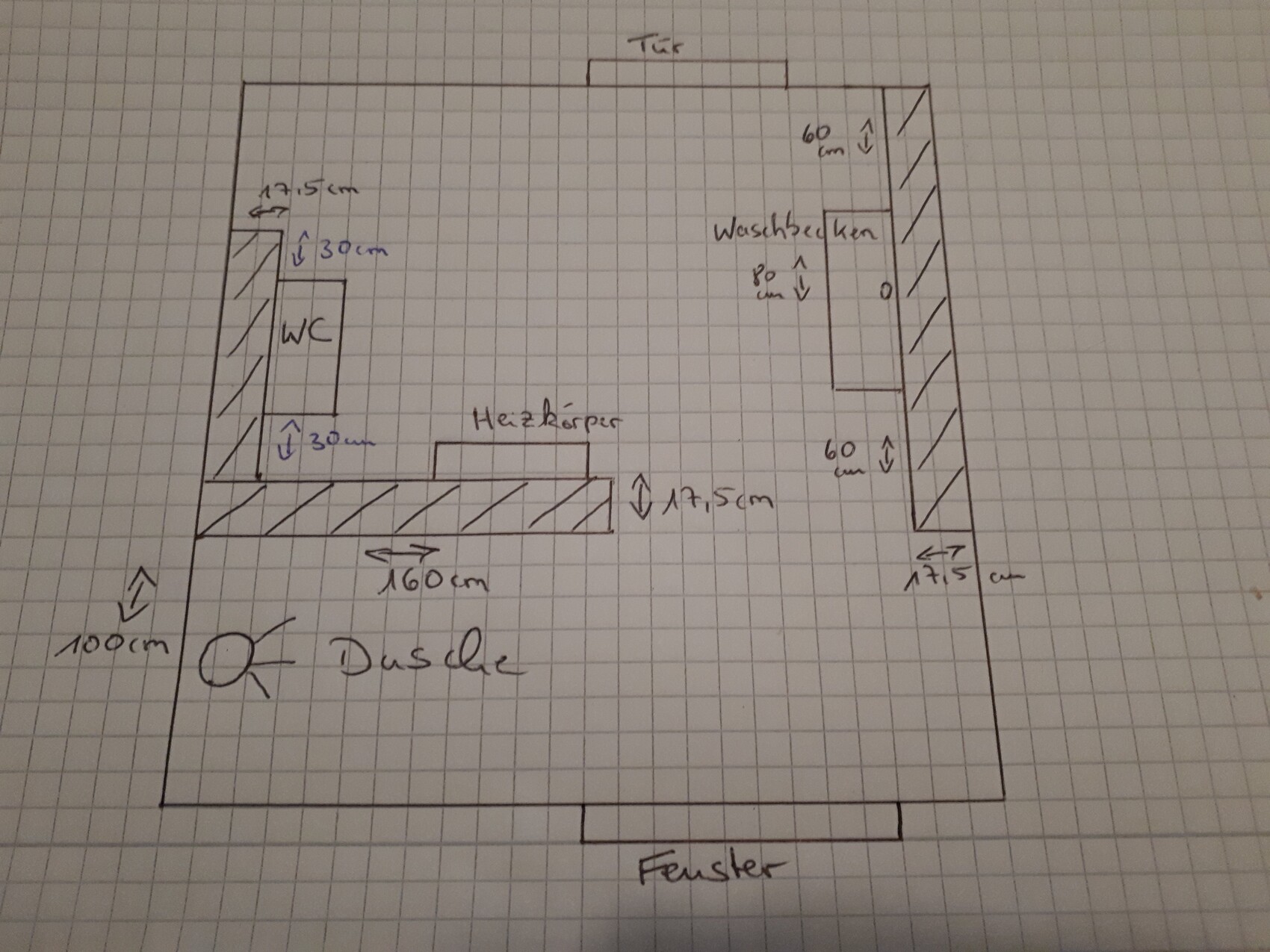

Bathroom: We decided on the following layout
We’re still not sure whether to build a lowered ceiling section above the sink now or add a countertop later.

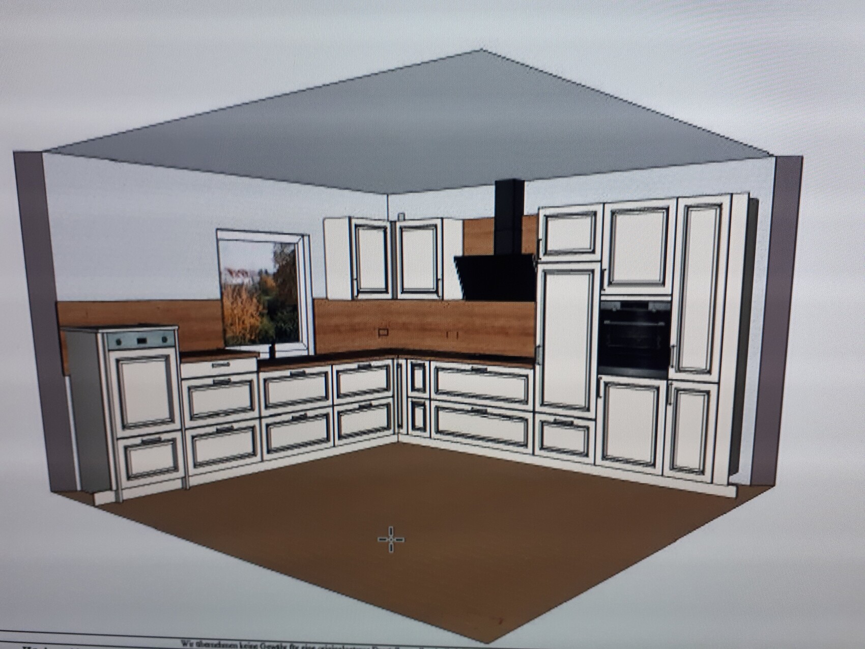

Kitchen: Same as the children’s room. That’s actually how it is. There will be a table and corner seating. We plan to add a shelf above the dishwasher later. The €400 (approx. $435) from the kitchen supplier was too expensive for a small shelf...

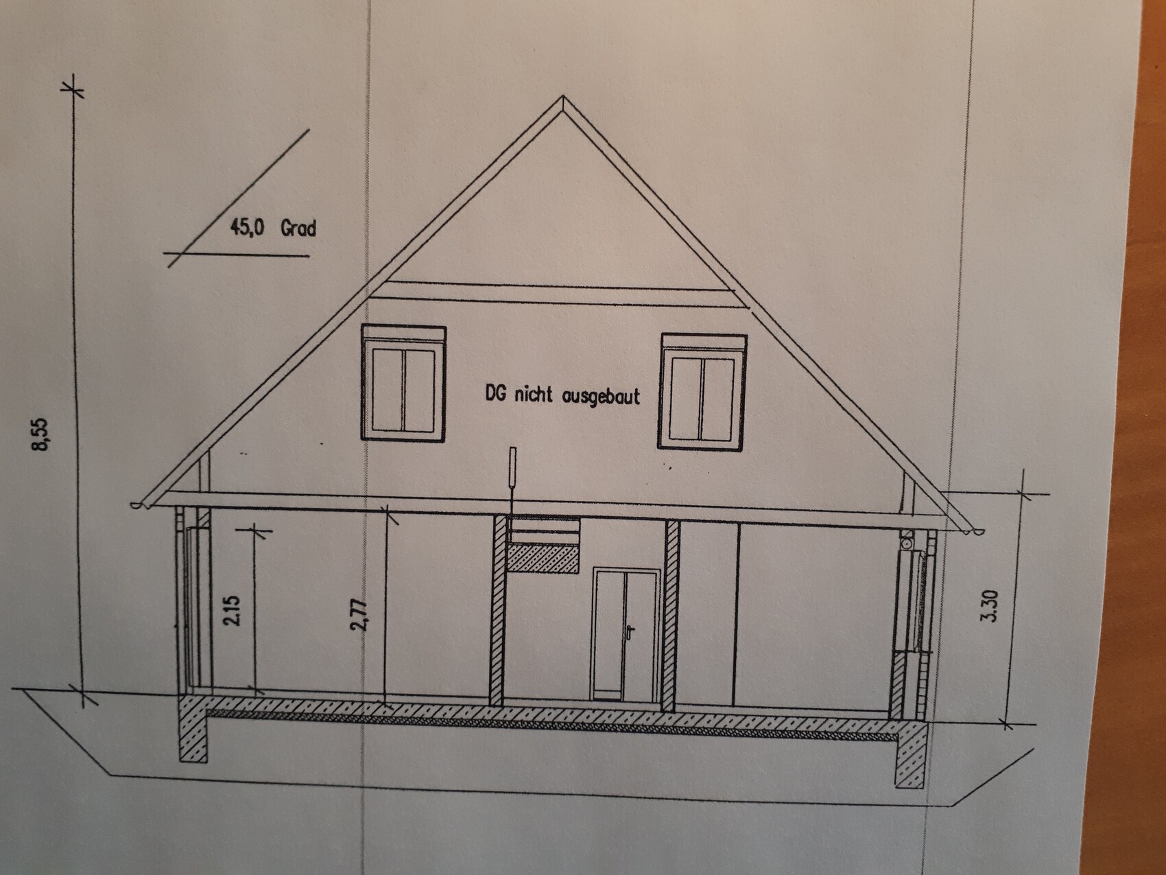

Here’s a cross-section
The attic height is 2.4 m (7 ft 10 in), I remember because we measured it. I think the top floor has 2.60 m (8 ft 6 in) floor-to-ceiling height minus 10 cm (4 inches) floor construction, and the ceiling cladding will probably take another 5 cm (2 inches).
The windows are currently estimated to sit about 5-8 cm (2-3 inches) below the beams, but this is due to the 24 cm (9 inches) roller shutter box on every window.
A knee wall (kniestock) of 1 m (3 ft 3 in) is not necessary. I think my children’s room had 70-75 cm (28-30 inches) and the bed fit tightly against the wall, and I could still sleep comfortably below it when I was younger.
I also generally like Hanse’s suggestion.
The stairwell is 3.5 m (11 ft 6 in) long and 1.1 m (3 ft 7 in) wide.

pffreestyler schrieb:
oh, I really stirred something up hereYes. pffreestyler schrieb:
Did I forget any information?Yes. I like the latest design for the upper floor best. But it only works if you optimize the staircase. So, what can you still change about the stairs?
Where exactly is the stairwell opening? Can it be moved or adjusted? How long is the staircase exactly? Has it already been ordered? What is the floor-to-ceiling height on the ground floor (i.e., what height does the staircase need to cover)? Is the roof pitch really 45°? Where exactly are the windows located on the upper floor? What empty conduits have you planned or installed so far?
The staircase is shown in the plan as 15x18.57 = 2.77m (9.1 ft). What is the actual distance between the ground floor finished floor level and the upper floor finished floor level? The 2.77m (9.1 ft) indicated on the section is from the raw concrete floor to the underside of the beam.
