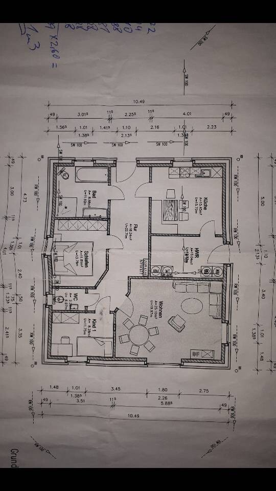

ᐅ Ground floor approximately 100 sqm, upper floor adaptable for expansion (planned bathroom, 2 children's bedrooms, 1 storage room)
Created on: 28 Mar 2018 10:32
pffreestyler
Plot size: 879 sqm (9,458 sq ft)
Slope: no
Site occupancy index: 0.3
Floor area ratio: 0.45
Building envelope, building line and boundary: 5 m (16 ft) to the street, 3 m (10 ft) each to the orchard area and neighbors
Edge development /
Number of floors: 2
Roof type: gable roof
Construction style: solid / masonry
Maximum heights / limits: ridge height 9.0 m (30 ft), eaves height 6.0 m (20 ft)
Other requirements
Homeowners’ requirements: living room facing south, small office (initially used as a nursery), walk-in shower on ground floor, utility room on the driveway side
Basement, floors: no basement, 1.5 stories
Number of residents, age: 2 – under 30
Office use: family use rather than home office
Number of overnight guests per year: 2-3
Open or closed architecture: closed
Traditional or modern style: rather traditional
Open kitchen, kitchen island: no
Number of dining seats: 6
Fireplace: no
Music / stereo wall: no
Garage, carport: carport planned later on the east side
Designer: general contractor
What do you like most? Why? living room facing south, the number of rooms as desired
What do you dislike? Why? the office window 1 should be moved from south to west (otherwise the wall looks too bare); driveway and access to be on the east, not the west
Price estimate by architect/planner: available after Easter; currently mainly focused on the floor plan
Personal price limit including fixtures: expected around €1,700 per sqm (sq ft conversion not added per instruction)
Preferred heating: gas
If you have to give up, which details/features?
-can give up: bathtub
-cannot give up:
The floor plan is based on a very similar layout seen during a house viewing and is our favorite among all viewings and catalog research. We only adapted it slightly to our needs (removed guest WC and enlarged living room, rotated office).
The floor plan basically fits us, but I would appreciate your opinion to see if any improvements are possible. Note: as mentioned, we want to move the office window to the west so the wall doesn’t look so bare. Driveway on the east, not west. Therefore, the bare wall on the west is where the carport will go up to the utility room door. Alternatively, a window could be added to the living room there and the carport start behind the house. The plot allows this.
My main concern is that we’re not 100% happy with the roof’s east-west orientation; I would prefer a north-south alignment. Do you have ideas on rotating the floor plan 90 degrees while keeping the layout mostly unchanged? Only the kitchen and office could be swapped.
PS: The square meter figures for the hallway may be incorrect; the contractor will finalize after Easter. Correct figures will be approximately: living room 31.79 sqm (342 sq ft), kitchen 15.19 sqm (163 sq ft), utility room 9.87 sqm (106 sq ft), hallway about 19.5 sqm (210 sq ft), office/child room 1 about 8 sqm (86 sq ft), bedroom about 11.8 sqm (127 sq ft), bathroom about 8.5 sqm (91 sq ft)
Plot details: length west: 40 m (131 ft), east: 42 m (138 ft), width: 21.5 m (71 ft)
Slope: no
Edge development /
Number of floors: 2
Other requirements
Fireplace: no
-cannot give up:

That won’t work either. You would run into the sloped ceiling.

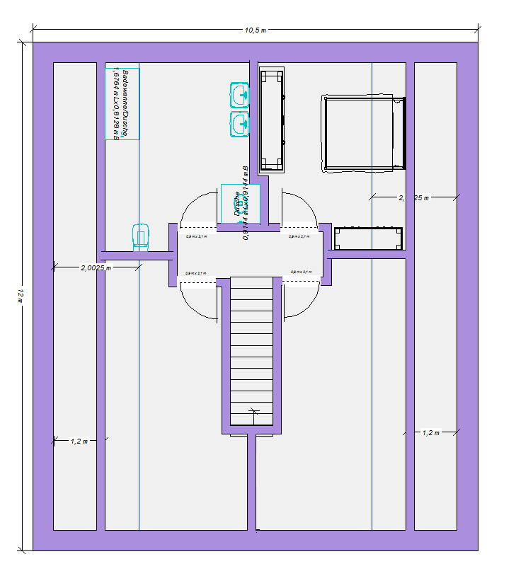

(But in an emergency, it might still be possible with a different door position) Yes, something like that:
Although here the staircase has simply been shifted somewhat toward the entrance. So far, nobody really knows exactly where it will be or how long it is, etc. The window is also still a question, as is whether the drainage could be routed all the way to the utility room.
Although the staircase has been shifted slightly towards the entrance here. So far, no one really knows its exact location or length, etc. The window is also still a question, and whether the drainage could be routed all the way to the utility room.
Some of the proportions don’t seem quite right.
pffreestyler schrieb:
But as I said, I’m only concerned about the upper floor. There we want 3 living rooms, 2 of which should be somewhat larger than the 3rd room, plus a bathroom and a small storage closet.Sorry, but you have to see it for yourself... Nothing will be spacious or appear spacious there. You will have a decent floor area, but overall it won’t be truly functional. Why do you want a bedroom and a bathroom up there as well? You already have those downstairs. Make it 2 children’s bedrooms, a storage room, and a shower toilet.
Exactly... because here in the entire neighborhood, despite an exceptionally good summer, no one does anything like that. So, a minor issue.
Regarding the attempts to squeeze 4 rooms up there: forget it. The homeowner will learn, when the time comes, that 2-3 rooms at most will have to suffice.
