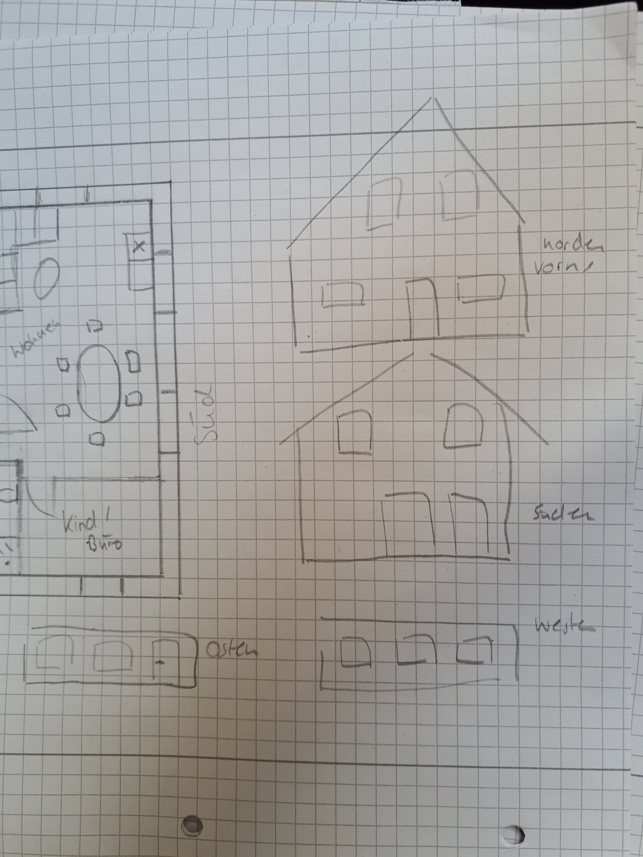

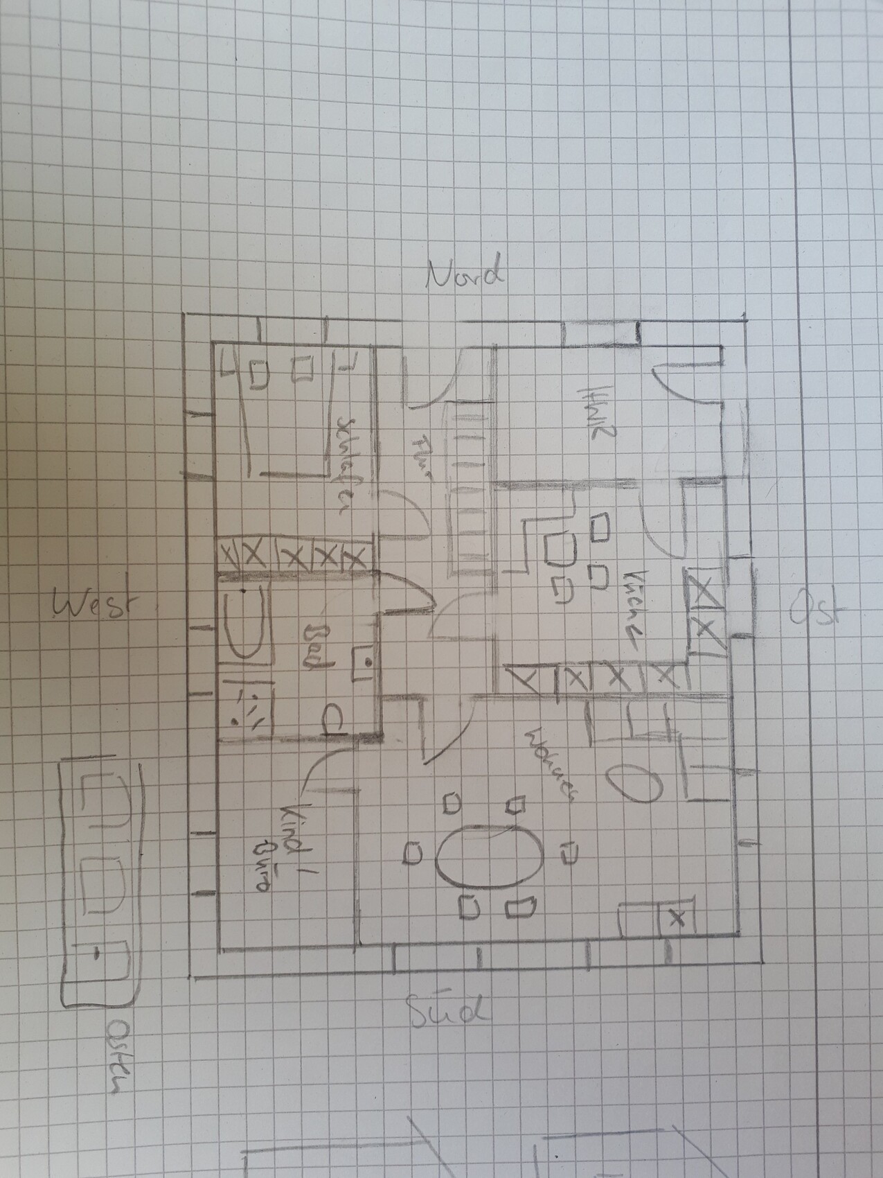

I was actually referring to odors in relation to a pass-through. What I did forget to mention, which might make my position a bit unclear for you, is that I am concerned that an additional window in the utility room would take up too much space for my ideas. However, this concern could be addressed by using a different window shape. The same would apply to the bedroom, as this way, not everyone would be able to see directly into it at first glance. We could also imagine not using a rectangular window but rather a flat, elongated one. That way, the bed, shelf, or something similar could still fit under the window. If such a window is on both sides, it also looks visually balanced.
This would also allow the staircase to have not just a straight run but a slight turn.
