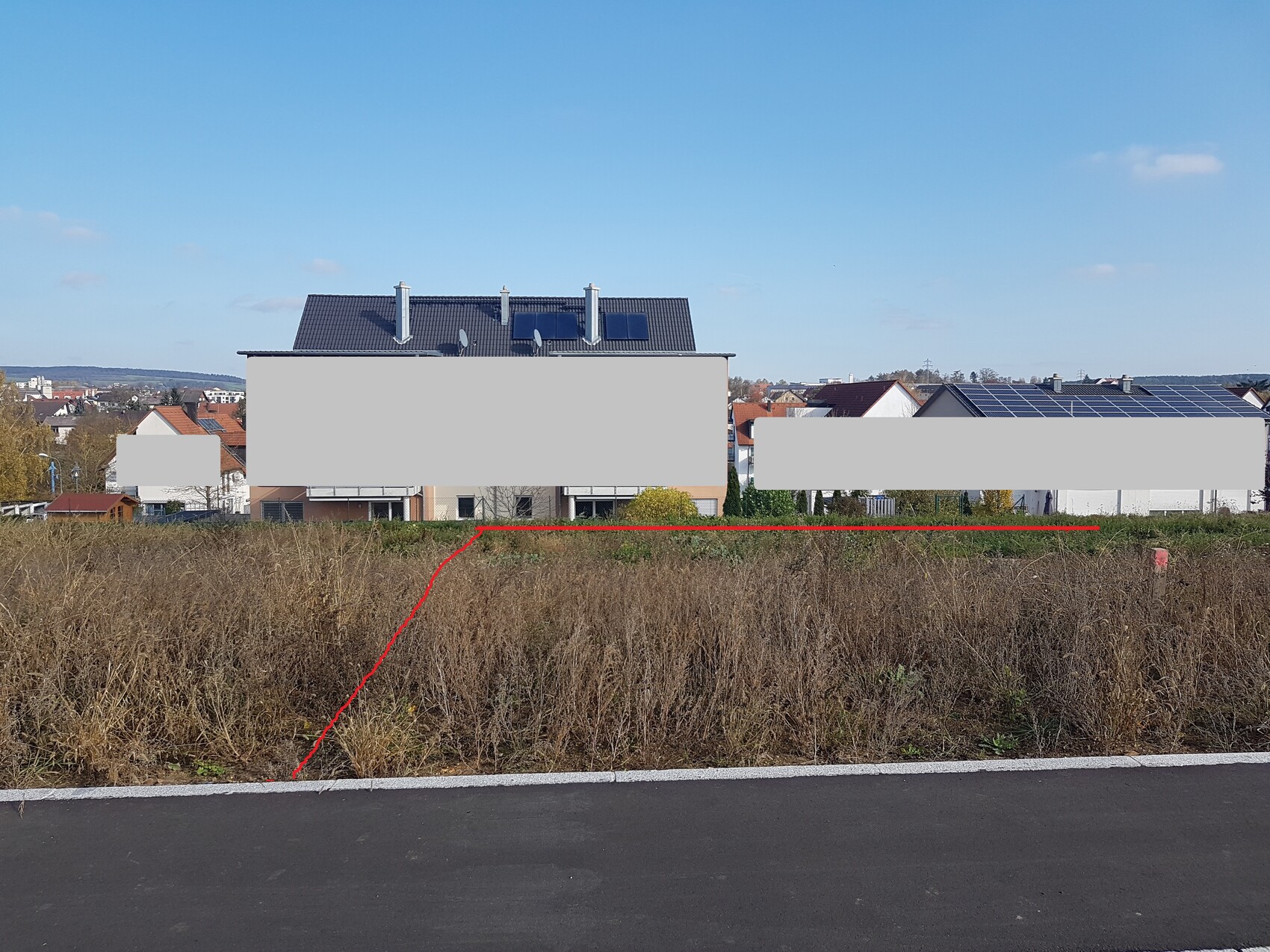

Yes, the lines shown mark the building boundaries. According to the development plan, however, garages are allowed directly on the property boundary. Garage and outbuilding boundary construction (the maximum wall height is 3.00 m (10 feet) above the top edge of the curb of the access road directly at the boundary between the plots). Yes, the street is marked in orange. The garage starts 5 meters (16 feet) inside the property; the house may be built parallel to the garage and does not have to be set back.
The plot slopes downward to the east from the street, meaning the street is at the highest point. Okay, so does that mean your front yard is larger in area than the backyard because the development plan requires it...?
If those lines mark the building boundaries, are you still allowed to move the garage roughly to the middle of the plot, even though it is marked as boundary construction? Because to me, the plan looks like the garage has to be right on the boundary.
But the house must be built exactly as shown?
Personally, I would also place the garage along the northern boundary so it doesn’t block the evening sun from the west.

Sternchen3128 Jan 2020 01:29ltenzer schrieb:
So, in your case the garden in front of the house is larger in area than the one behind, because the development plan requires it...?
If those boundaries shown are the building limits, are you still allowed to position the garage roughly in the middle of the plot, even though it’s marked as boundary construction? Because to me the plan looked like the garage must be exactly on the boundary.
But the house must be placed exactly as shown?
I would put the garage on the north boundary so it doesn’t block the evening sun in the west. Hello, yes, the garden will be at the right corner of the house, in front of it, and it also wraps around the right side. The front garden is definitely larger and flatter than the one at the back, and importantly, it is on the sunny side. We have flexibility to position the house anywhere within the building boundaries, but the garage must be built along the boundary with the neighboring property. It doesn’t matter if the garage starts 5 meters (16 feet) or 8 meters (26 feet) into the property. Since the plot is sloped, it reportedly makes sense to build the garage right at 5 meters (16 feet), otherwise we would need to add a lot of fill to create a level base for it. The house could be moved further into the plot, so it wouldn’t necessarily start parallel to the garage but maybe 2 to 3 meters (6 to 10 feet) further back. However, that would mean the basement would open out into the backyard more.
Unfortunately, we cannot place the garage completely on the north side, as that would involve driving downwards into the garage, which we were advised against.
Sternchen3128 Jan 2020 01:37ltenzer schrieb:
Okay, sorry, I misunderstood you. I thought your plan showed the garage located between the house and the street. All good, that can easily be misunderstood based on the plan. The "transition" is a covered walkway between the garage and the main entrance. The kitchen and dining room also face the street.
Sternchen31 schrieb:
All good – this can also be misunderstood based on the plans. The "passage" is a covered walkway between the garage and the main entrance; the kitchen and dining room also face the street.Okay, the layout of the rooms makes more sense now. I still find the size proportions too tight in the kitchen and pantry, while the son can set up a roller coaster in the living area. Also think about yourself and the distance from the couch to the refrigerator . The kitchen and pantry might suit a small apartment in central Munich, but not a nearly 90-square-meter (970-square-foot) open-plan living space. It looks like a dollhouse kitchen.
