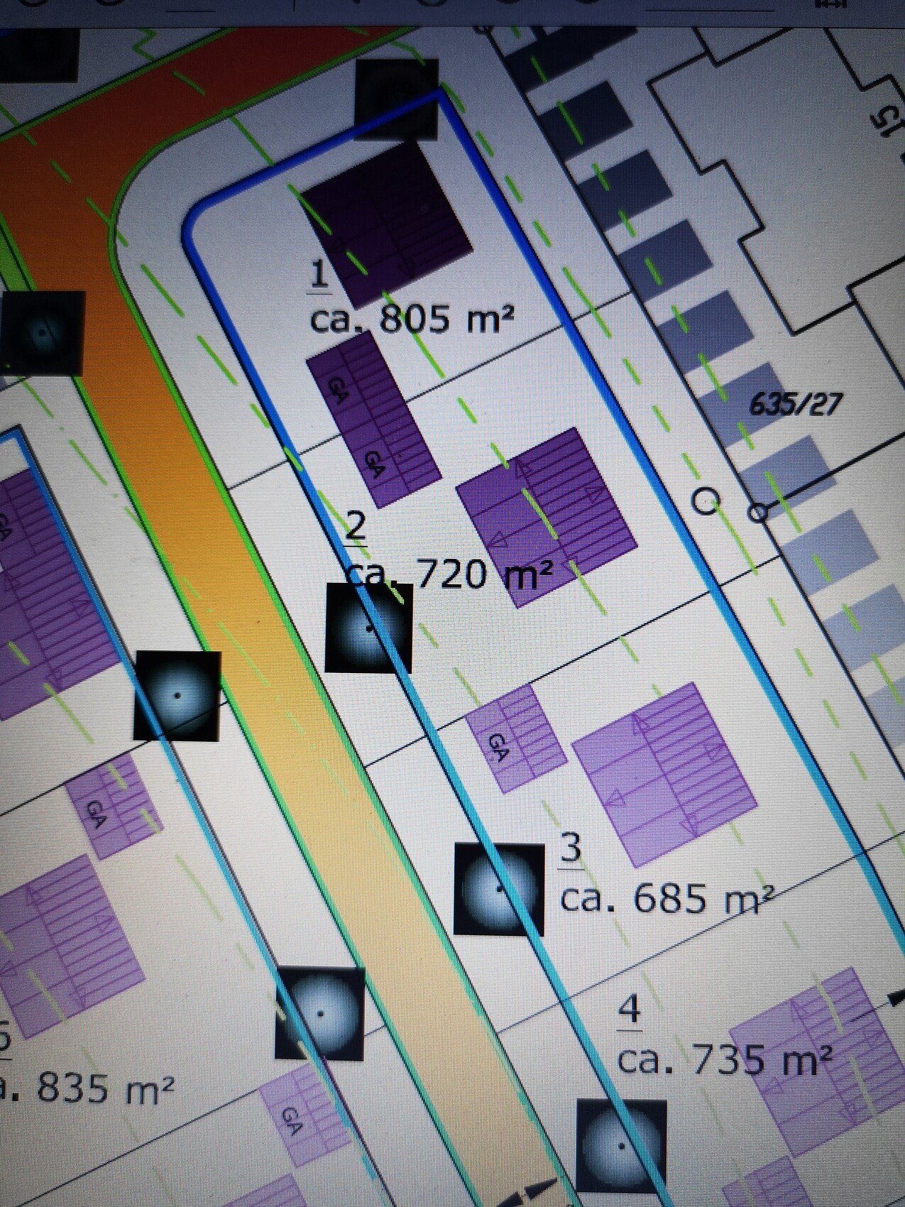

Attached is the site plan – our plot is Plot 2.
The drawn garage is located to the northwest.
Sorry that the image is so poor, I couldn't do better on short notice. But if the drawn lines represent the building boundaries, then you shouldn’t place the garage directly in front of or beside the house, but only offset diagonally along the northwestern property boundary?
Is the orange area the road?
And which direction does the slope descend?

Sternchen3128 Jan 2020 00:50ltenzer schrieb:
But if the marked lines are the building boundaries, then you are not allowed to place the garage directly in front of or next to the house, but only diagonally offset along the northwest property line?
Is the orange area the street?
And which way does the slope run? Yes, the marked lines are the building boundaries. According to the development plan, garages are allowed directly on the property line. Boundary construction is permitted for garages and outbuildings (the maximum wall height is 3.00 m (10 feet) above the finished surface of the access road, directly at the boundary between the plots). Yes, the orange marking represents the street. The garage starts 5 meters (16 feet) inside the property; the house may be built parallel to the garage—it does not have to be set back.
The land slopes downward to the east from the street, meaning the street is at the highest point.
