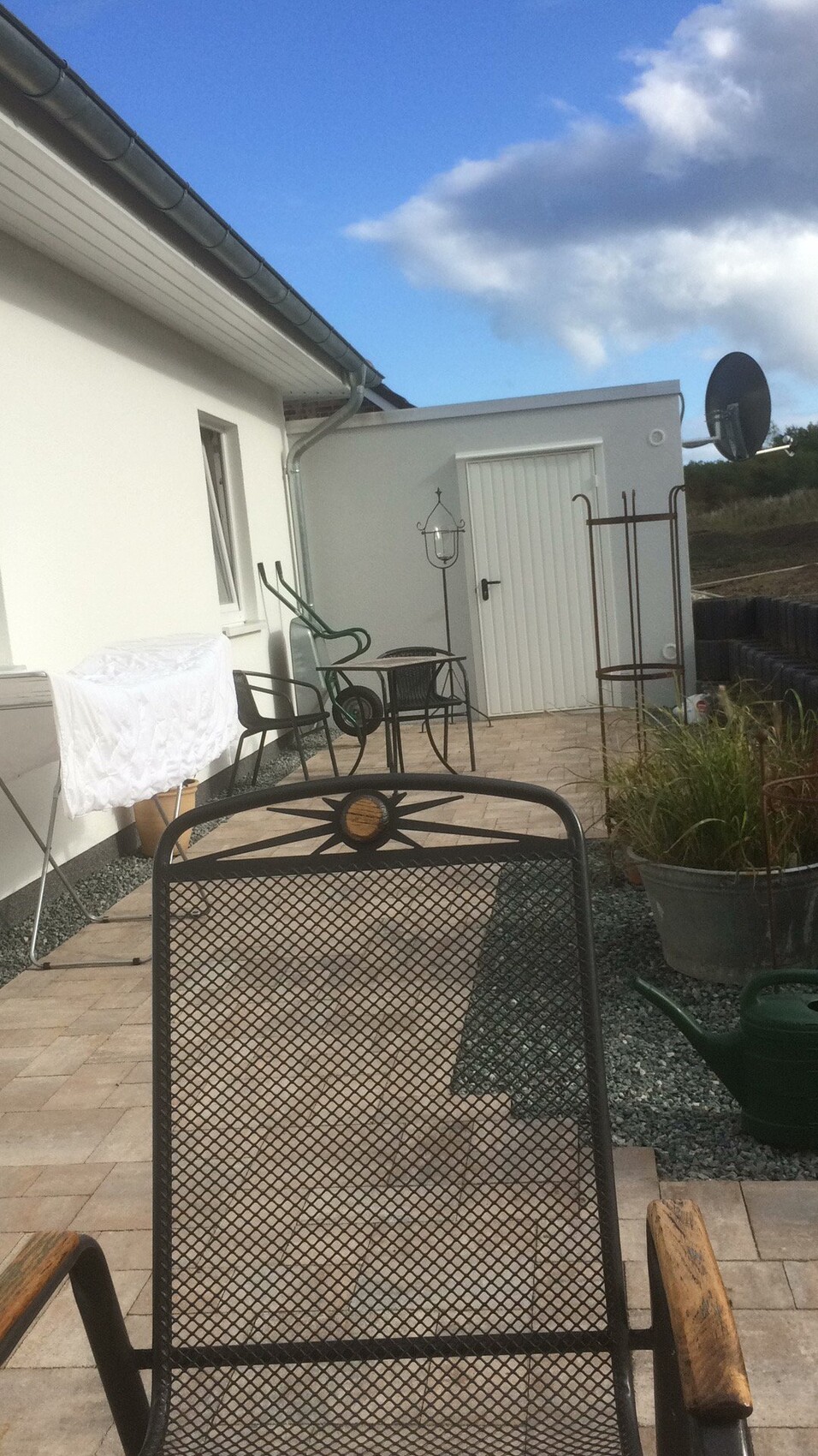

It is generally recommended to install a perimeter drain around the house, connect it to the rainwater drainage system, then add a layer of sand, followed by a layer of gravel with a geotextile fabric underneath to prevent weed growth.
It would look like this:
Terrace with garden furniture, planters, and a light-colored house in the background
