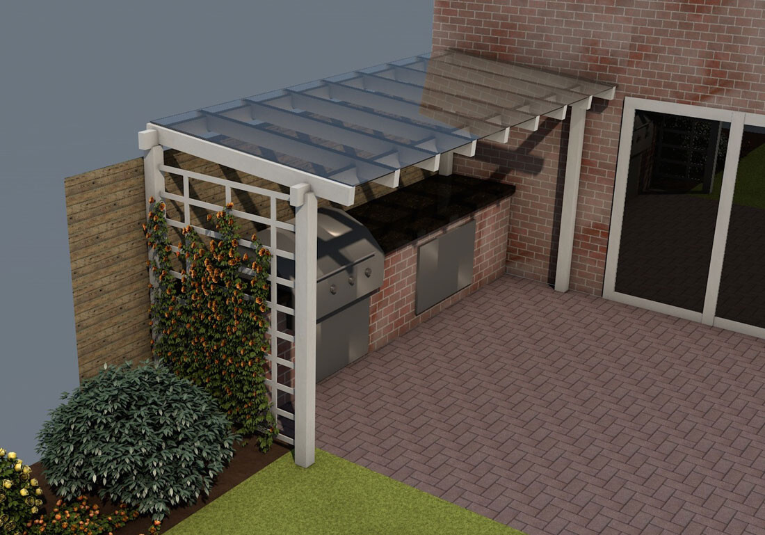

This is what the finished result should look like:

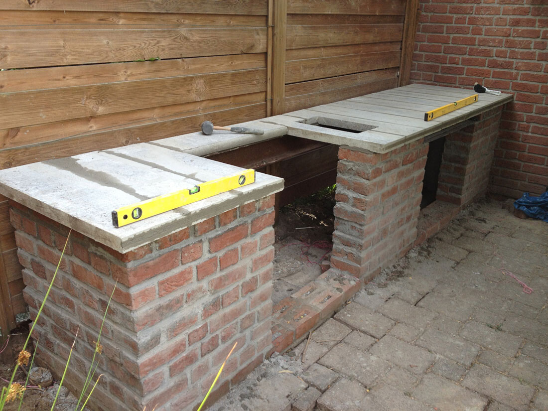

For the base of the countertop, I laid concrete lawn edging stones – as seen here:
Now, I was told that there could be stresses caused by this, and I shouldn’t install the granite tiles (61 x 30.5 x 1 cm (24 x 12 x 0.4 inches)) directly onto the concrete parts. Of course, I would use a proper flexible tile adhesive, but that alone would not be sufficient – I would need at least an uncoupling membrane to prevent cracks in the granite tiles due to tension.
