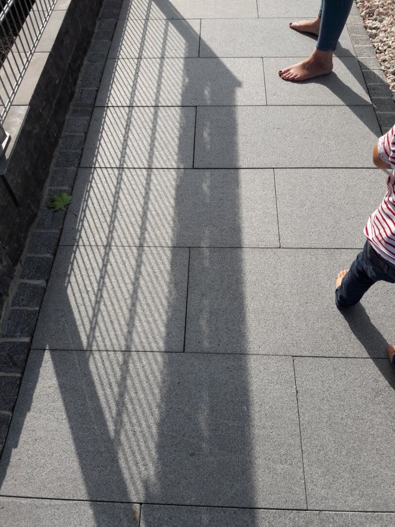

Hmm, we have granite slabs that look just like in the photo, but I’m not sure what exactly you’re asking [emoji15]
They are natural stone, not impregnated, and they are installed outdoors.
After three years, we still haven’t done anything to them, and I don’t really know what we would impregnate... and yes, you can now slightly see some marks that could be brushed. So far, this doesn’t bother the picky homeowner (me).
