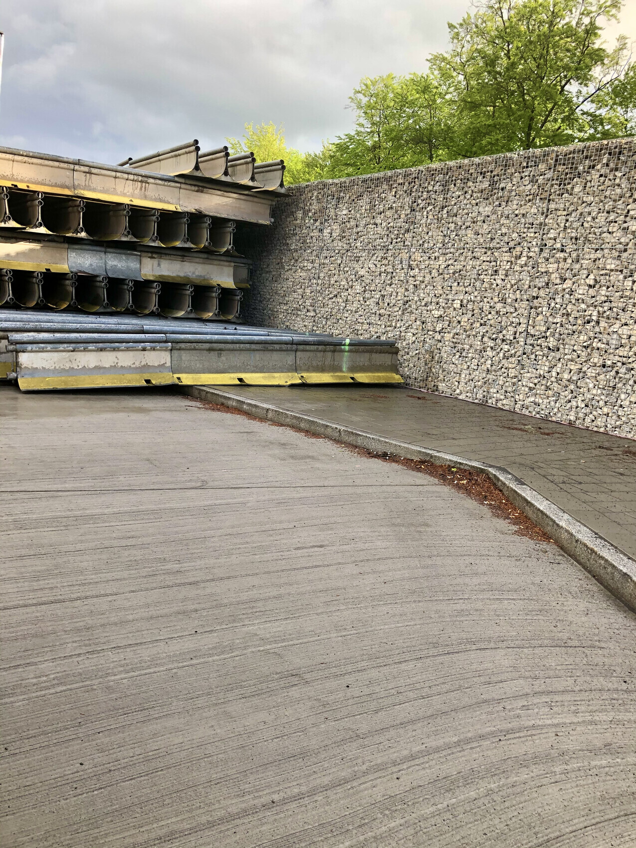

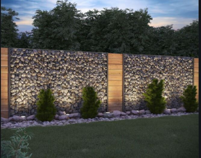

I thought of gabions while on the go. They have both mass and a diffusely reflective surface, and they absorb sound better than masonry. I find them quite bulky and would let them become overgrown.
There are also very slim gabion walls with support elements.
