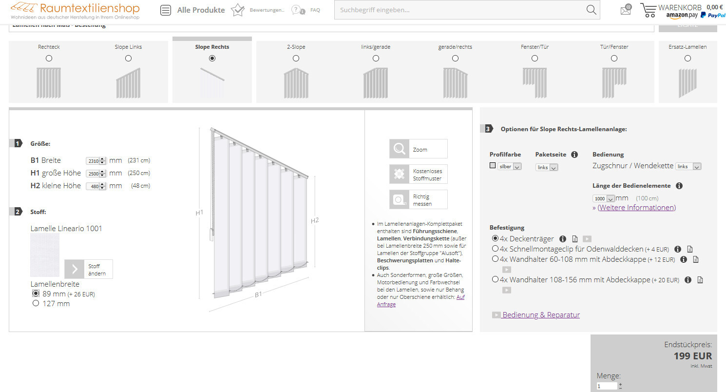

I would suggest placing PAX carcasses with contents there, cutting them to size as needed, and then installing vertical blinds in front. This would be done in two sections: one for the straight part and one for the section with the sloped ceiling.
So, approximately 150 cm (60 inches) PAX at standard height, then about 100 to 150 cm (40 to 60 inches) PAX gradually shortened, and towards the end maybe just shelves or open space for suitcases, etc.
The niche is simply planned to be 70 cm (28 inches) deep, allowing a vertical blind to run comfortably in front.
The sloped section, for example (not more expensive than PAX doors either):
