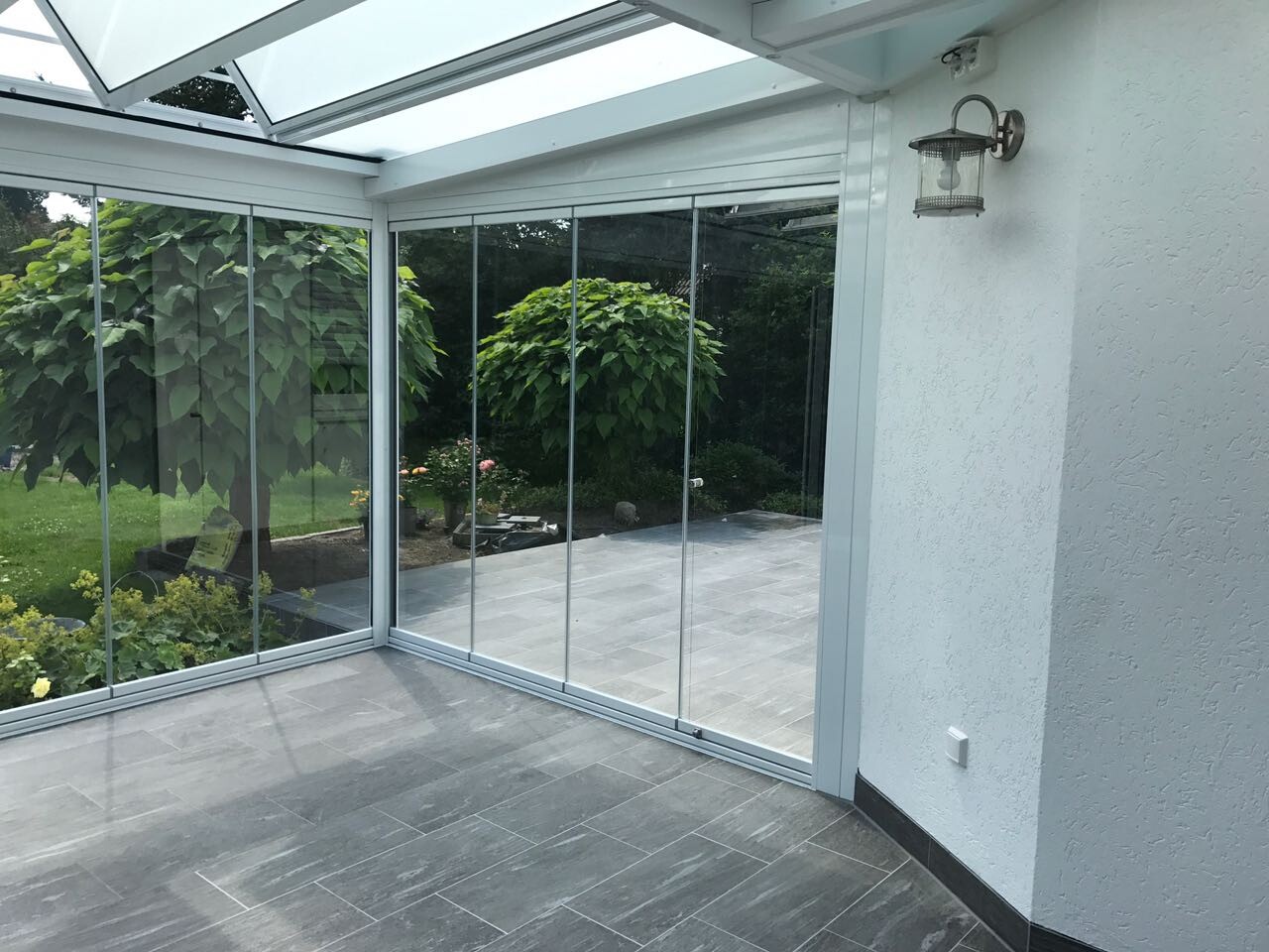

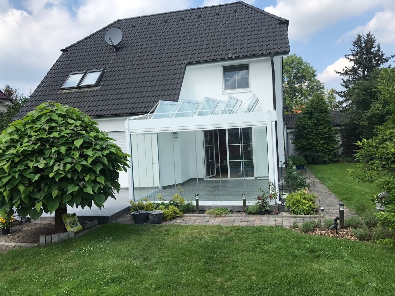

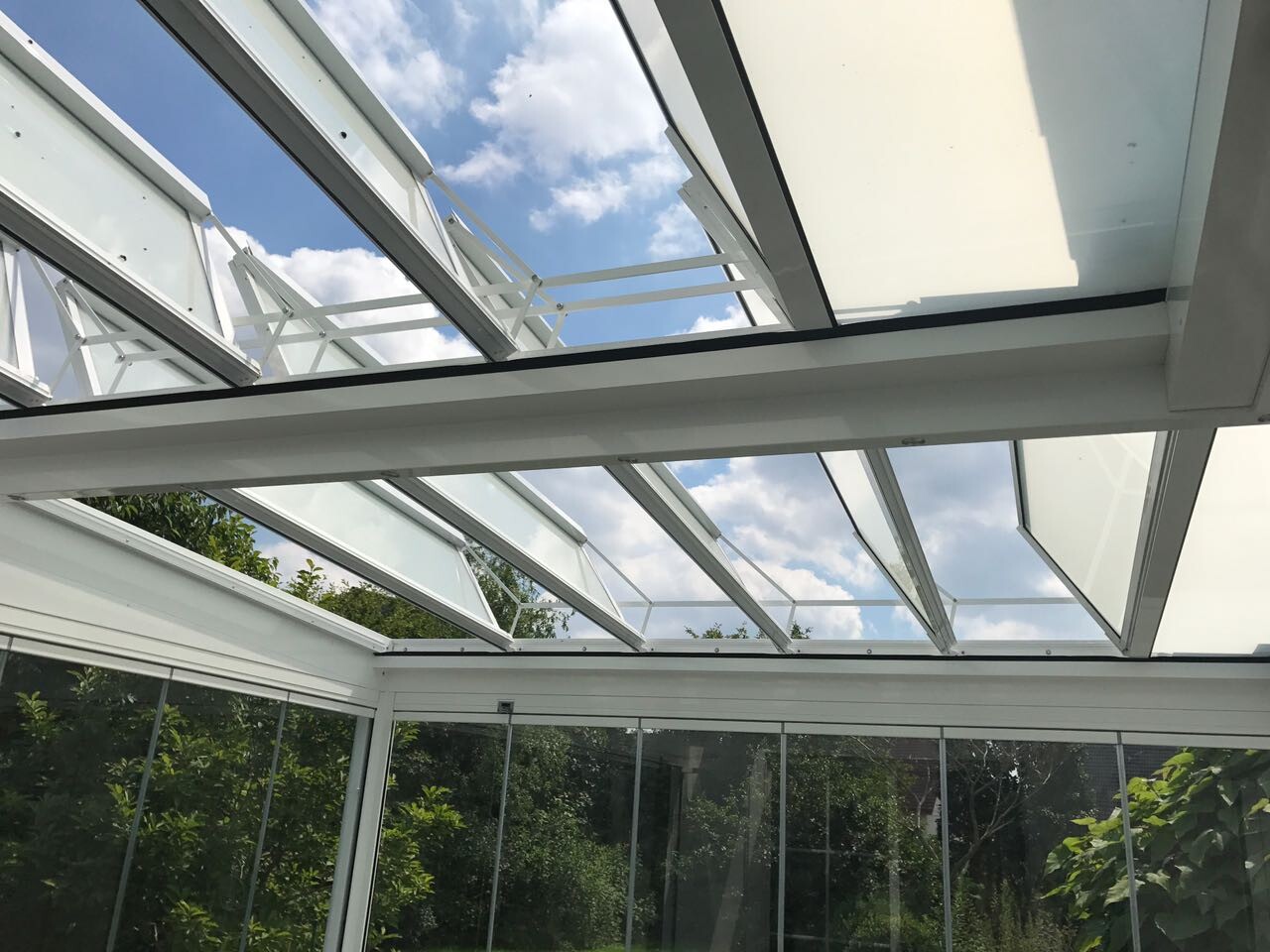

Last year, we treated ourselves to an aluminum glass louver roof with a folding glass system, and we are very impressed.
Especially now in winter, when it’s so cold outside, we can sit in our cold conservatory that stays between 18-20°C (64-68°F) on sunny days.
But you need to be careful. There are many suppliers online offering the same system, but most are just distributors, not manufacturers. There are not many companies that can actually produce this kind of system. In Germany, I believe there are only four, and not all use glass for the louvers—some only use twin-wall sheets, which was not an option for us due to the drum effect.
Regarding light transmission, we haven’t noticed any loss because you can choose between clear glass and opal glass. As for heat during the peak of summer, it’s still bearable underneath because we can open the louvers, allowing the hot air to escape from above.
Overall, we are very satisfied so far and can definitely recommend such a roof.
Price-wise, it was quite affordable if you buy directly from the manufacturer and have it installed.
If anyone is interested, I can also send some pictures.
