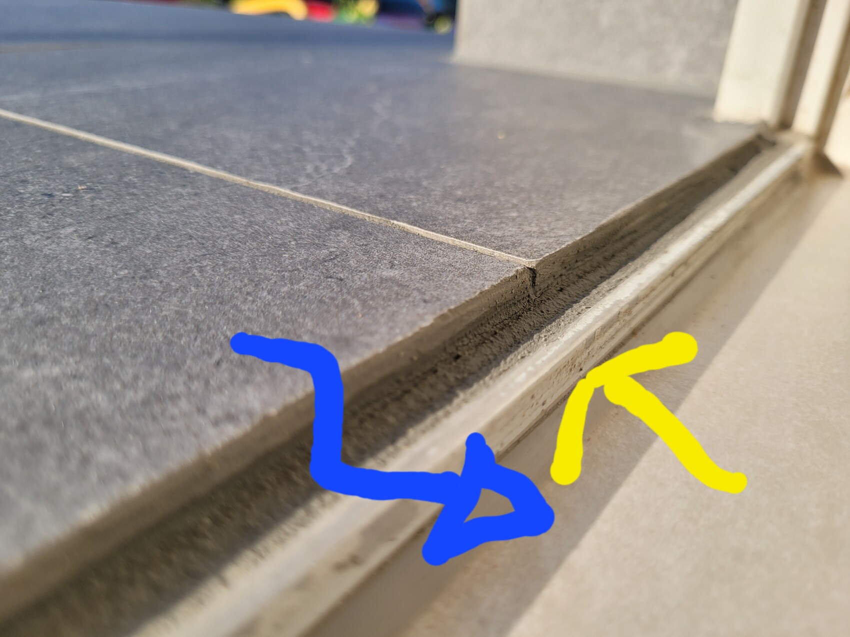

Again. As you yourself write, the door presses against the tile edge with a rubber seal, which serves as a stop. This ensures the seal. It is supposed to be at least somewhat airtight.

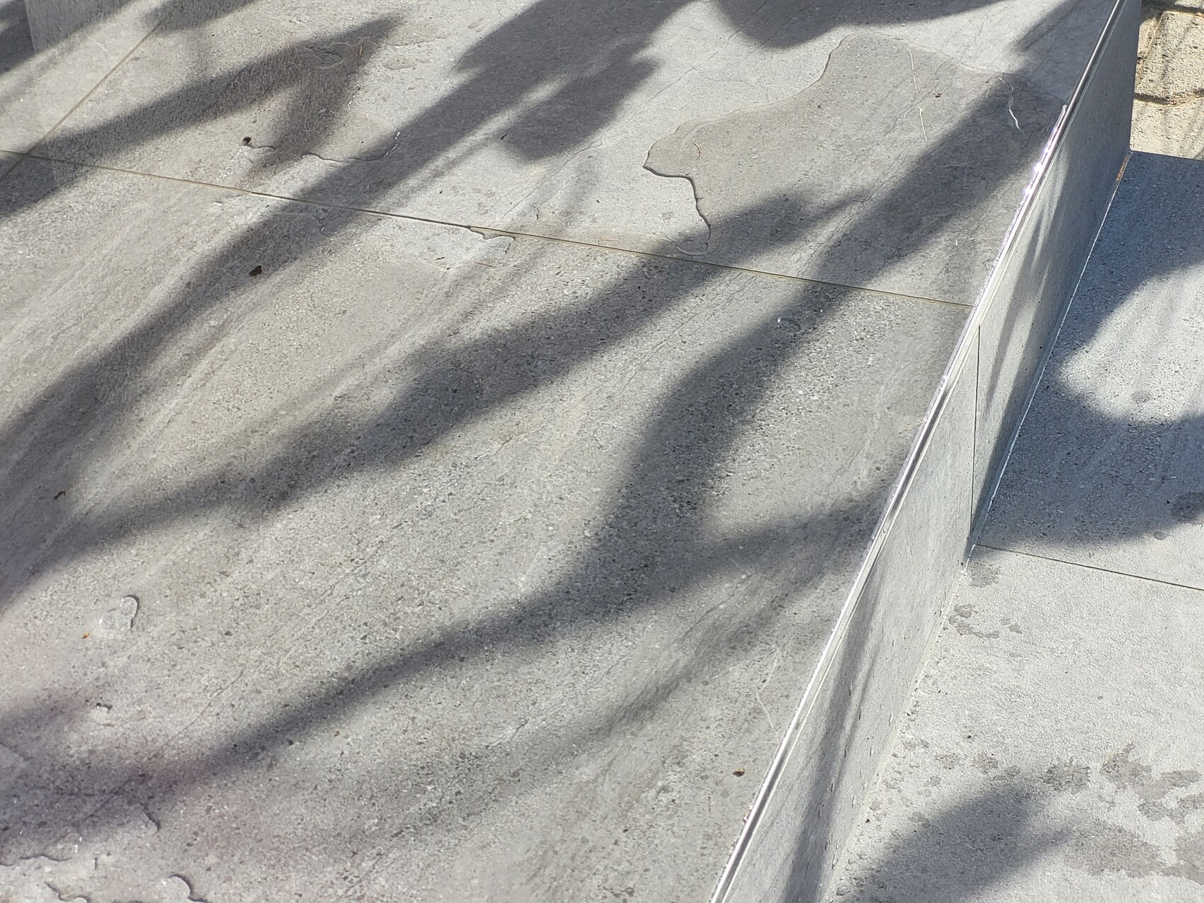

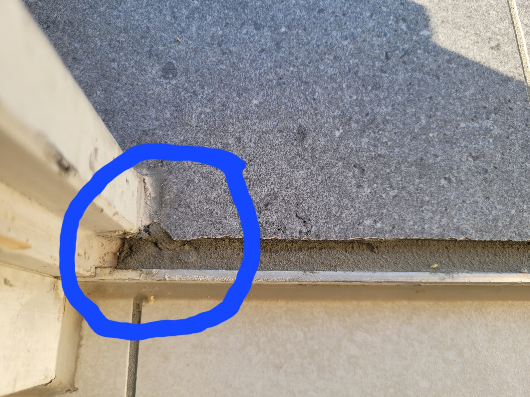

No, not exactly. The rubber lip presses against this first rail... this is not the tile edge but the door threshold (see yellow marking). Therefore, the raised tile edge carries a certain risk of water ingress (blue marking). Probably most likely from the side (second image). And yes, there is a slope there. However, it is a very slight slope. He said it was no longer possible.

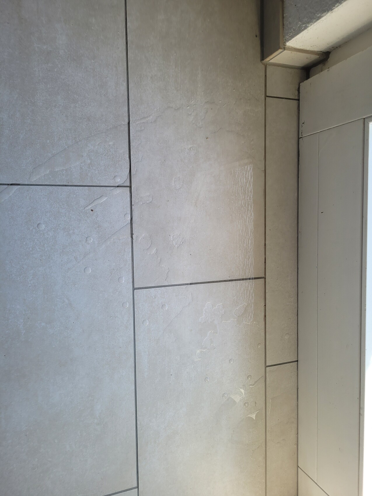

Yesterday, I also did a test by briefly spraying water from a garden hose against the door, and the flow was relatively weak. Water entered within a few seconds. My neighbor said this would happen even if the edge were flush with the metal strip on the door. It was like that before, but I’m not sure. Water also accumulates along the edge of the stainless steel strip at the front of the platform.
