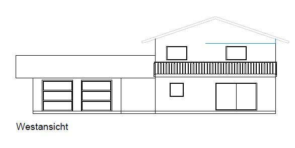

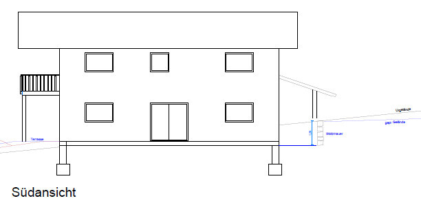

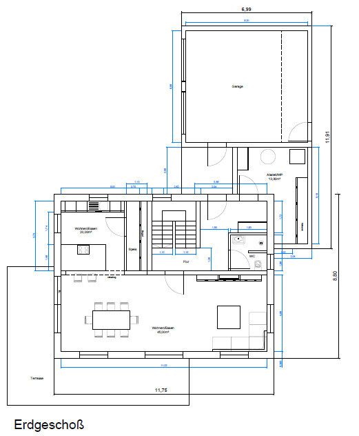

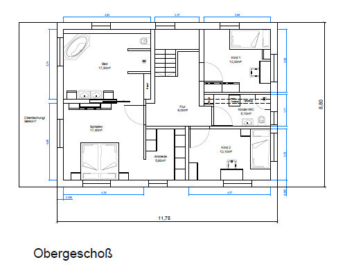

Regarding the attached plan: I created it myself, but please don’t judge too harshly. Although I trained as a technical draftsman, my focus was on heating systems, so I only incorporated what I picked up about construction on the side. Whether this is feasible from a construction or structural perspective still needs to be clarified, and I would appreciate any tips or opinions here.

Slope: see section drawing, estimated only!

The budget doesn’t fit.
Even with your own work, it’s not feasible now and certainly not in two years.
Try to eliminate major cost drivers like the extension.
There is a lack of storage space; a house must be self-sufficient and functional. This is not a 100 sqm (1,076 sq ft) extension.
Where is north?
Kitchen facing the terrace.
Living room is huge.
Children’s rooms are very small.
Parent’s room is disproportionately large and impractical.
Visit show homes to get a better sense of sizes.
With this area, it’s possible to add an extra bedroom, a utility room, and properly sized children’s rooms.
Where is north?

Obstlerbaum21 Dec 2018 20:35The child’s room in the northeast still gets morning sunlight. I would suggest bricking up that window right away. Perhaps the attic could be converted exclusively into a master/wellness area, and the children moved down to the basement?

The layout on the upper floor isn’t very good yet.
The bedroom is too large (only for sleeping). I would place both kids’ rooms facing south (north is at the top, right?). Then plan the bedroom and bathroom afterwards.
The ground floor looks spacious; in principle, the open-plan area is quite interesting. And it can’t really be too big – cramped situations can be avoided. Have you also tried working with different variants? For example, starting once with the kitchen, another time with the living room?
