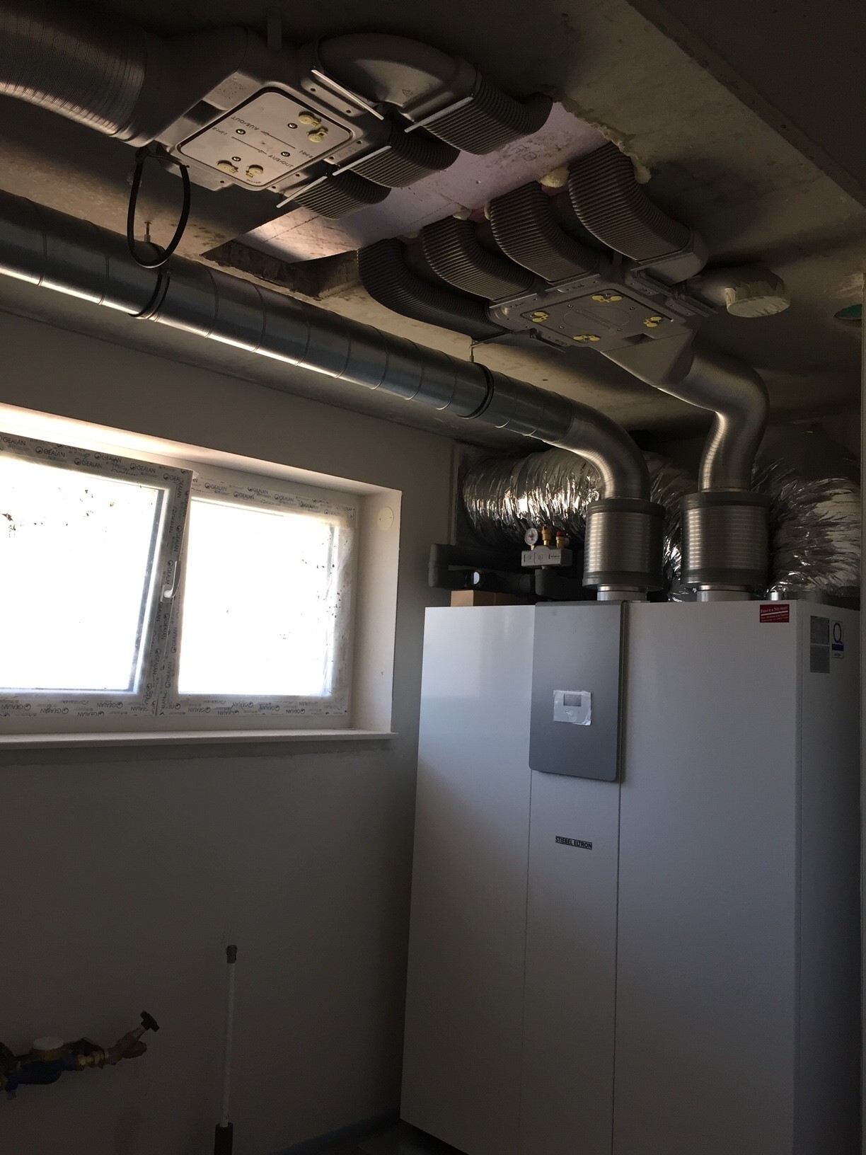

boxandroof25 Apr 2019 07:38Nordlys schrieb:
Air-to-water heat pump. Now a proven technology. Relatively high space requirement in the utility room. Regarding the space requirement, it depends. Compared to gas systems with a storage tank for solar thermal, this generally applies only to special solutions such as combined ventilation units or air-to-water heat pumps without an outdoor component. In our utility room, there is only a 200-liter (53-gallon) storage tank with a base area of about 70x70 cm (28x28 inches) plus a few pipes attached to the wall. The frequently used split units with integrated storage tanks are also not very large.
