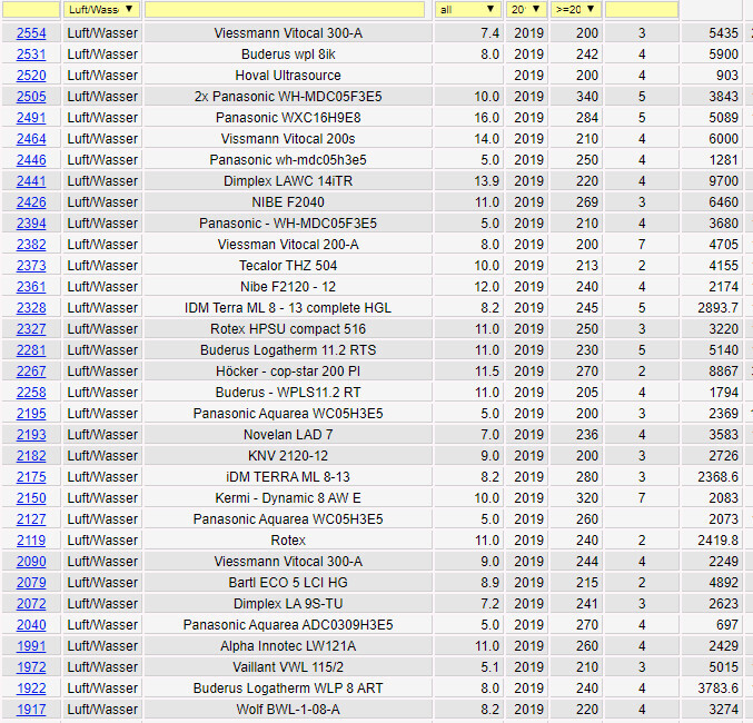

Check the heat pump consumption database. You’ll find real figures there—typically new builds (extract for 2019 and area over 200 sqm (2,150 sq ft) below / some consumption values are very low if the system was only commissioned during 2019). The
Okay, I looked a bit and almost all of them have underfloor heating, so it’s hard to compare directly.
