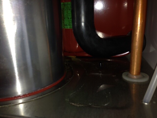

our heating system is leaking water, more precisely: within one week (mostly when heating up, like right now) it gets damp and water runs out. Not much, but still noticeable.
Key details: second winter, heating system was installed in October 2013. Gas boiler from Wolf with an integrated hot water storage tank (solar). It doesn’t seem to be the Wolf tank that is leaking.

Regards, BauexperteHere is a photo from my phone... the dark red enameled part further back with the green sticker... there is a rust spot at the bottom.... 🙁
Bauexperte23 Nov 2014 13:43It looks like the expansion tank and isn’t a big deal to replace. So keep your chin up 😉
