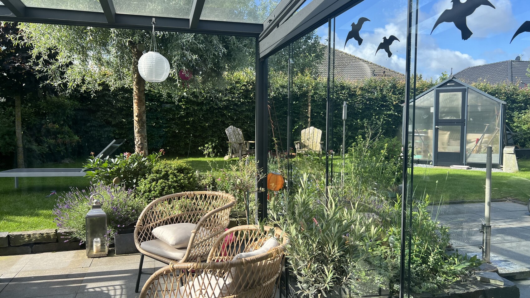

I'll show you our 2-year-old "teak chairs" (this is a photo from last month, as I scrubbed them and removed the dirt over the weekend). You’ll need to zoom in—they’re in the back. So, be careful with cheap purchases.
Gartenlaube mit Glaswänden, Rattanmöbel, Lavendel, Laternen und grünem Garten.
