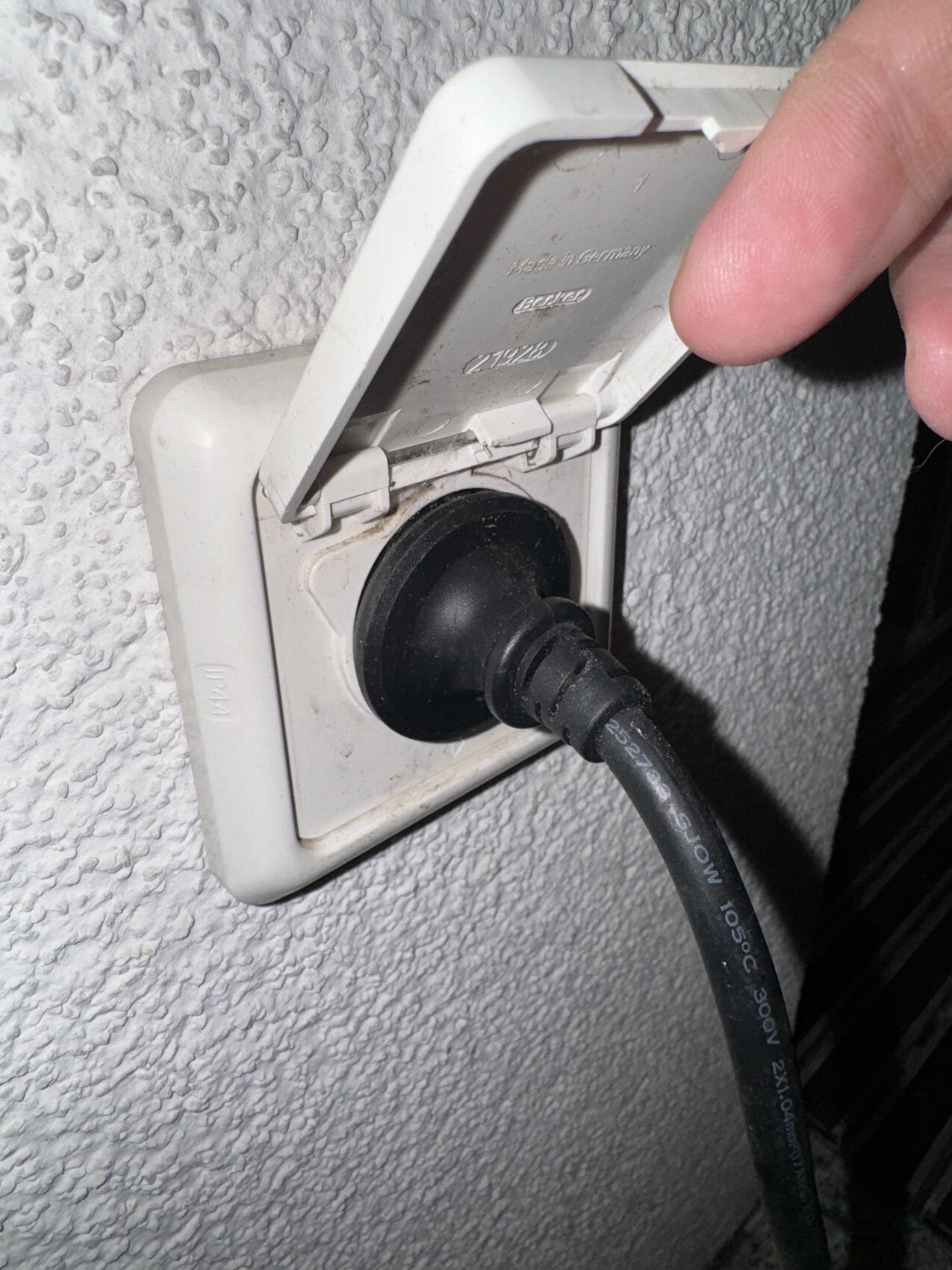

FrankChief schrieb:
The Schuko plug of outdoor devices is designed to fill the entire socket and therefore provide some sealing. No, or only minimally.
FrankChief schrieb:
Or am I misinformed? Yes.
Have you ever actually plugged such a plug into an outdoor socket outside of forum theory?
This is the plug of the Hue IP67 power supply in an IP44 socket. It doesn’t seal anything beyond light drizzle at best:
