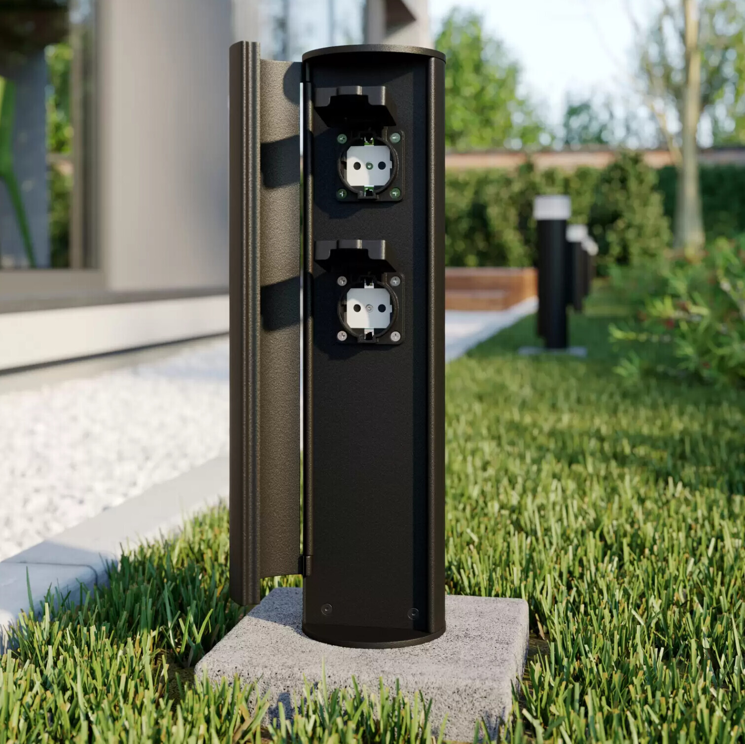

Steven_197713 Jun 2024 19:39Hello
Hello Frank,
As long as no puddle or small pool forms around the socket column, an IP44 column is sufficient. You just need to ensure that no water can accumulate around the base of the column and that it does not stand in a puddle during or after rain. You might also consider building a small pedestal under the column (as shown in the picture).
Steven

Hello Frank,
