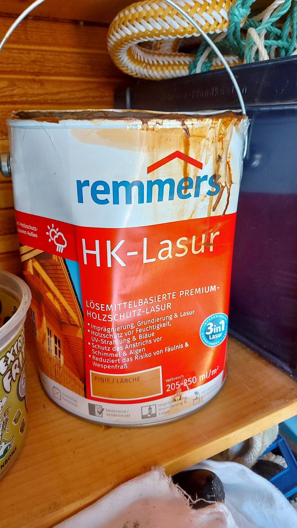

Similar situation with us regarding tight space to the neighbor,
we used a 3-in-1 stain,
primer - impregnation - stain,
and painted all boards and beams twice before assembly after drying.
It is important to use a colored stain, as clear stain will make the wood turn gray.

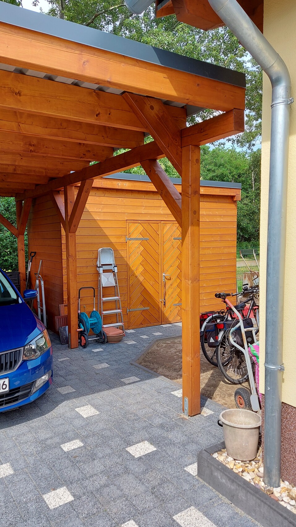

Nida35a11 Jul 2021 16:07
This is not a thick-layer stain, so tongue and groove joints still fit properly.
Our general contractor recommended the stain for the wooden parts of the house, and we reordered it for the carport and shed. It is available in various colors.
