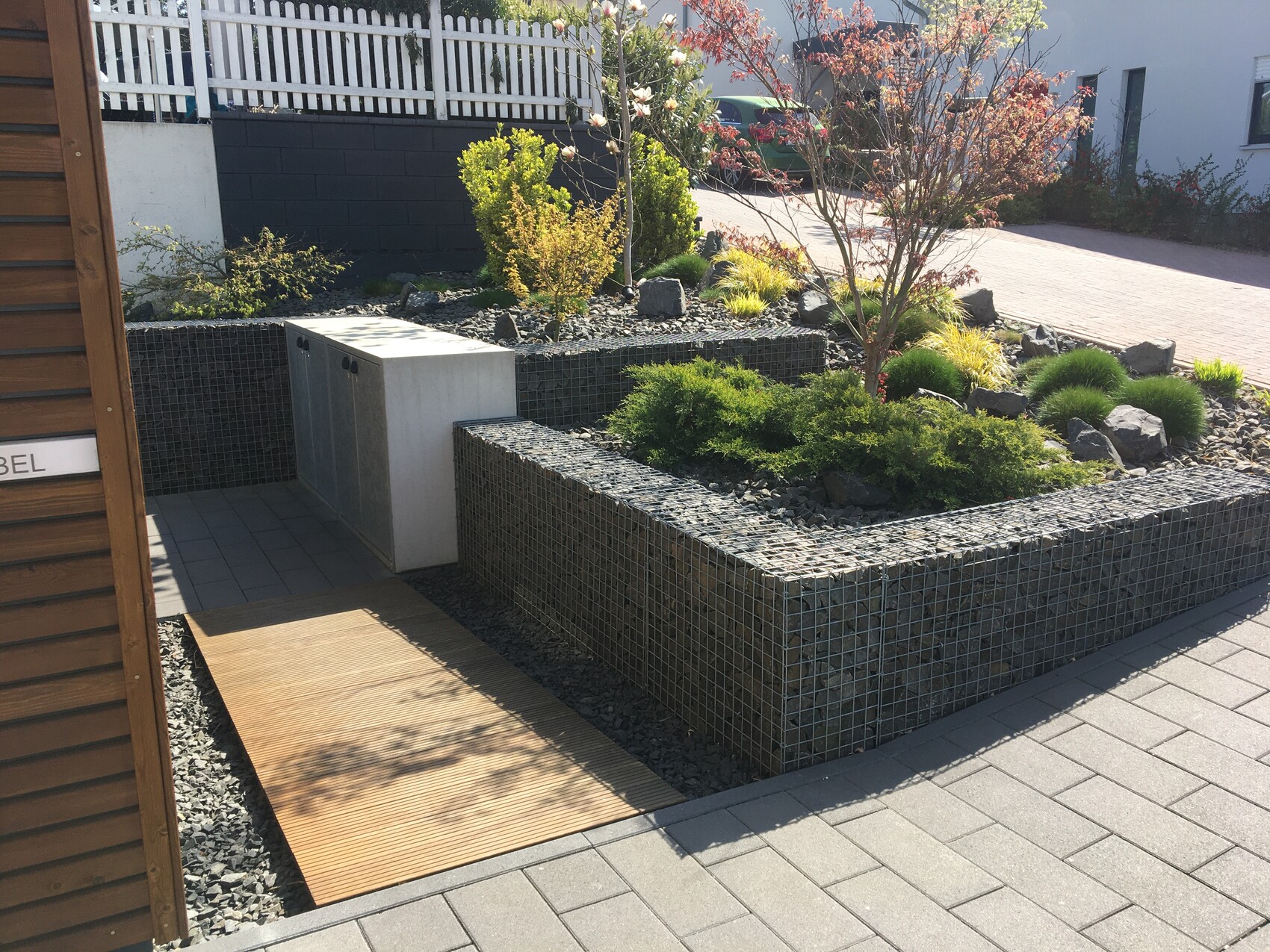

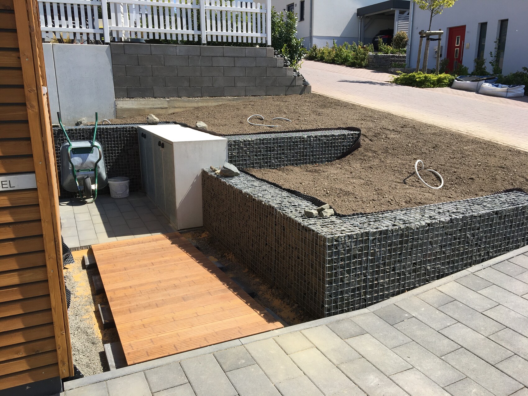

Do you have a photo for us?Better late than never... the before and after should be clear from the pictures...
knalltüte7 Apr 2020 16:11Hello, may I ask how much the small houses cost and what exactly the models are called? I only need to cover about 40cm (16 inches), but that would already solve part of the problem, and the tanks also have to be placed somewhere ...
We drove to Mönchengladbach on a Saturday to the factory outlet of Paul Wolff and picked out two small houses, which were delivered shortly afterward. I believe it was the model 242. I have no idea how much we paid for them, but it was definitely quite a bit cheaper than what these usually cost. Second choice, but I don't understand why...
