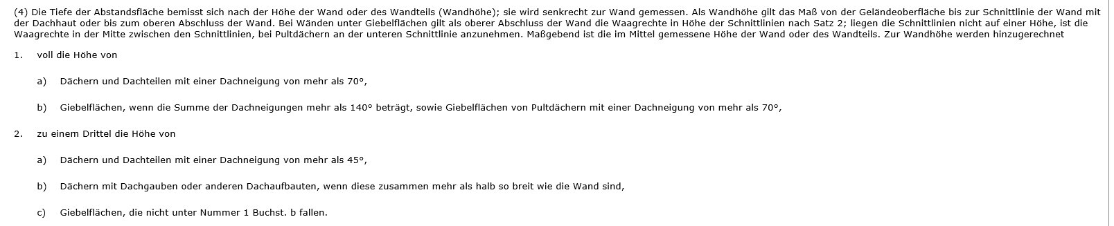

Building permit application with form and neighbor’s signature. Costs 100 euros.We will most likely not get the neighbor’s signature, so we have to comply with the state building regulations of Rhineland-Palatinate (RLP). I looked them up and I think that a roof with a pitch of up to 45 degrees up to the desired height could be the solution (because this, see below, is not included in the measurement) if I understand it correctly.

To be honest: This whole situation is unacceptable, and as a neighbor, I would take action against it, if necessary through legal means. Someone is putting up a 4.20-meter (14 feet) wall right in front of me, and then three meters (10 feet) further, there’s a house built at full height—light, air, sun, everything gone. Or I can go along with this nonsense and spend tens of thousands on fill and reinforced concrete retaining walls... instead of leveling the plot by cutting the front and raising the back, as everyone does here. The zoning plan requires it, and it works perfectly. KarstenExactly, since our neighbor is not giving permission, we want to build according to valid laws, of course. That was my only question: For a garage roof pitch of 45 degrees or less sloping toward the property line, is this roof counted toward the average wall height? Many thanks in advance.
