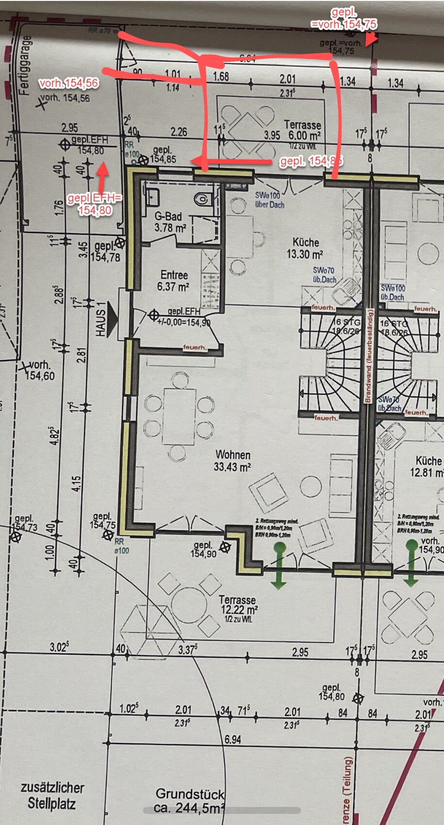

So, is it about this corner? The terrace is larger than originally planned?
[ATTACH alt="garagennebentuer-oeffnet-nicht-bei-ebenerdiger-terrasse-602545-1.jpeg"]75802[/ATTACH] Yes, exactly, we have extended the terrace.

WilderSueden26 Oct 2022 22:24Only the developer can probably explain the purpose of having two terraces and a garage set far back on a property of about 240 sqm (2,583 sq ft). I also find 6 sqm (65 sq ft) to be quite small, but fully paving the entire backyard is no solution either. I would completely remove the front terrace, enlarge the rear terrace to 3 x 4 m (10 x 13 ft), and position it with a 1 m (3 ft) gap for a privacy hedge next to the neighbor. Then create a path with a slightly steeper slope leading to the garage, similar to the layout shown in the picture. But instead of large slabs, use small paving stones.
