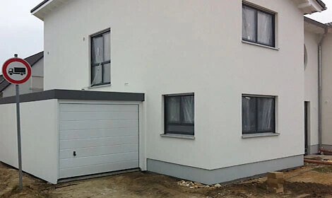

Here is an example on which I base this. And in the picture you can’t even see the details like plaster texture and color. Thin walls or side panels of the garage don’t match the house at all. The house base stops at the garage. It just looks slapped on. The huge joint that is smeared over is visible even in the poor picture because it shines white.
In short, it looks out of place. The example in the picture can even be worse, for example with a very thick, visible aluminum strip towards the house on the garage roof for sealing, or even on the front side. I want to avoid that. One look is enough and you immediately know it’s a prefabricated garage, not particularly well integrated.
