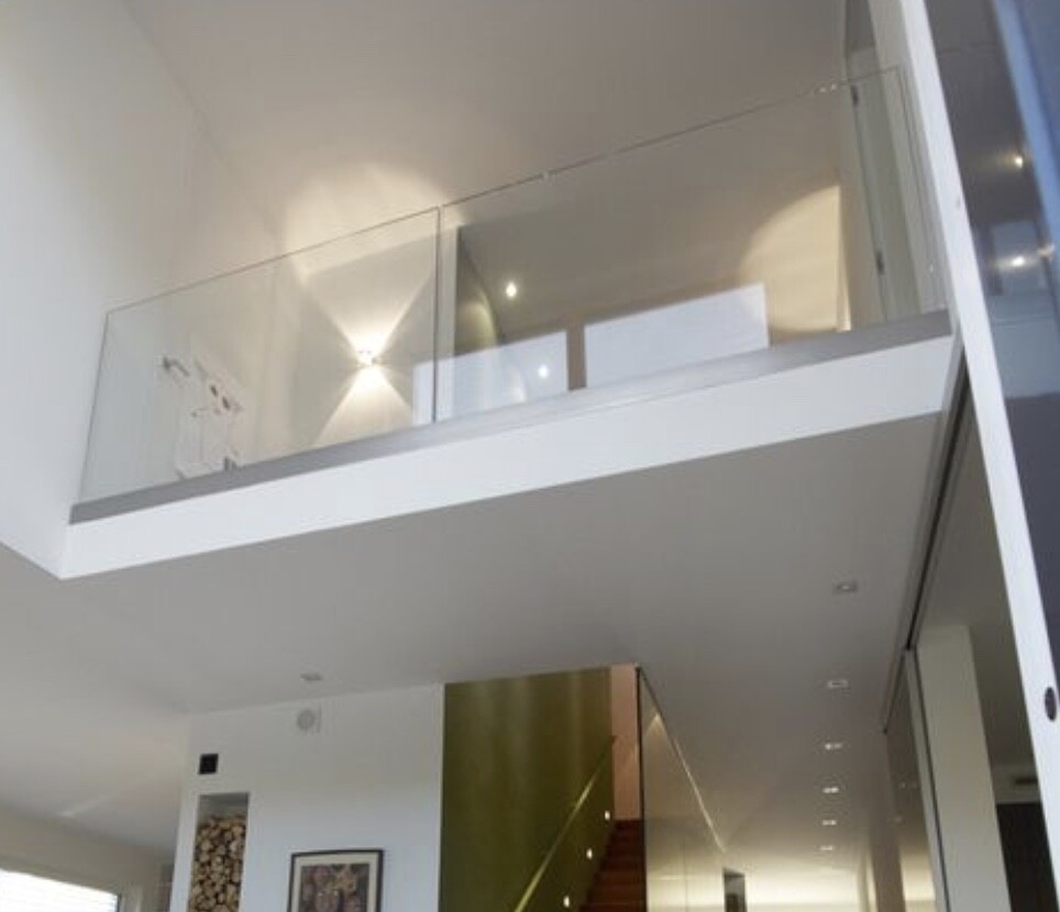

Aluminum base profiles with general building approval (abP) are available for about 165€/m (50€/ft). These are usually installed using M12 anchor bolts. With some DIY skills, you can do this yourself.
Anchor bolts of M12 are placed every 250mm (10 inches) in the concrete, which secures the profile very well. I chose a version with an L-profile, meaning the screed is poured onto and over the profile.
Additionally, I installed a laminated safety glass (VSG) made from tempered safety glass (ESG) with a thickness of 17.52mm (0.69 inches) for about 600€ (3m x 1.1m / 9.8ft x 3.6ft). In total, my railing including the mounting hardware cost around 1150€. Depending on preference, a handrail made of stainless steel or alternatively wood can be added.
The result is a glass railing that rises directly from the floor without any visible mounting profile.
Glaziers and locksmiths quoted around 3000€ for such a railing.
So I saved about 1800€ by planning it myself and completing one day of installation.
