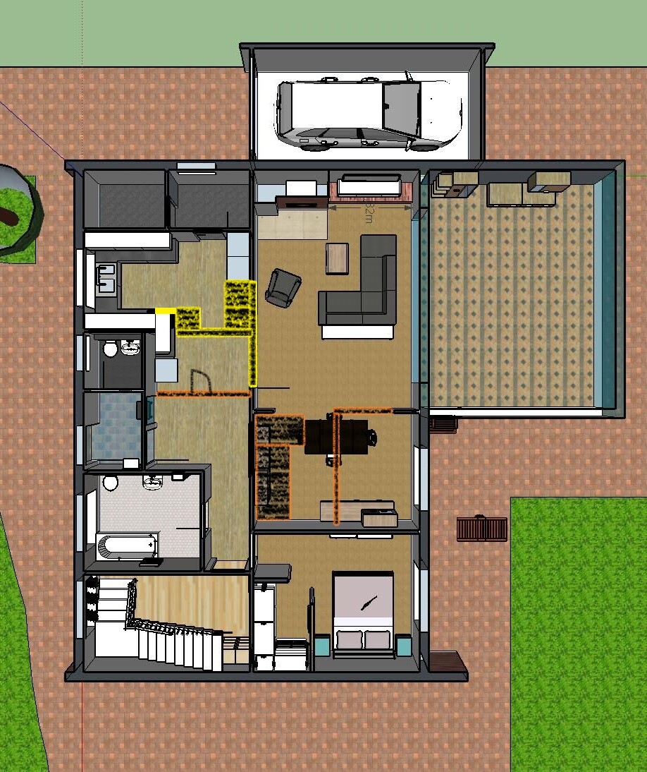

Exactly, the lower section can be rotated.
Yes, that’s the wall where the staircase was supposed to be – at least according to the realtor.
Due to the symmetrical layout, both walls are exactly the same length (4.25m (14 feet)).
The wall you suggest is only 3m (10 feet) up to the opening. I find the idea quite appealing right now, but it probably doesn’t fit, does it?

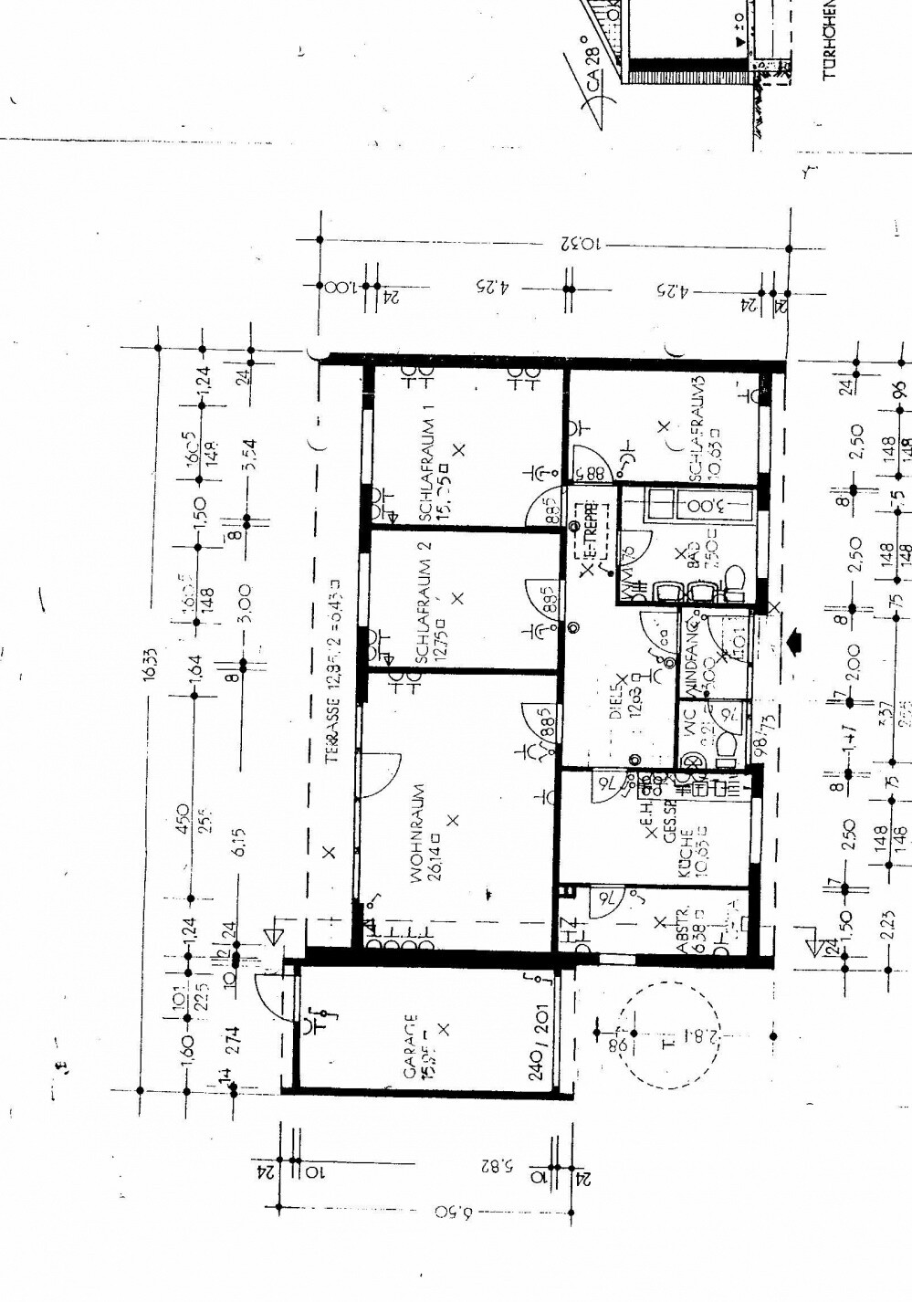

You mention load-bearing walls. According to the construction description, load-bearing walls are made of “8–10 cm (3–4 inches) Termocrete concrete,” non-load-bearing walls of “7 cm (3 inches) Termocrete concrete.” Looking at the floor plan (the original one here, without the conservatory, which at least is properly dimensioned), only the wall to the windbreak and guest bathroom would be non-load-bearing. Could that be correct?
Anyway, your staircase suggestion is sparking some ideas. We plan to create an opening to the kitchen later, as we like open spaces. In our current apartment, only the guest room, bedroom, and bathroom have doors.
This brings the flooring question back in. With floating floors, I could fairly easily remove and reuse the areas. Glued planks would have to be torn out and replaced in the kitchen/hallway area.
Since the extra space would be great for the dining table—and we have the huge conservatory—it would feel like a waste to keep the dining room. If the staircase is inside it (which I actually like for open spaces), I couldn’t separate the room again.
If the staircase were on the other wall, the other half of the room could be used as a study or guest room.
I roughly sketched this out. Orange indicates new walls and the staircase, yellow the walls and cupboards to be removed.
If the staircase ever bothers someone in the living area, one could alternatively reopen the door underneath the stairs, fully close the wall to the living room, and assign the staircase and access to the study to the hallway.

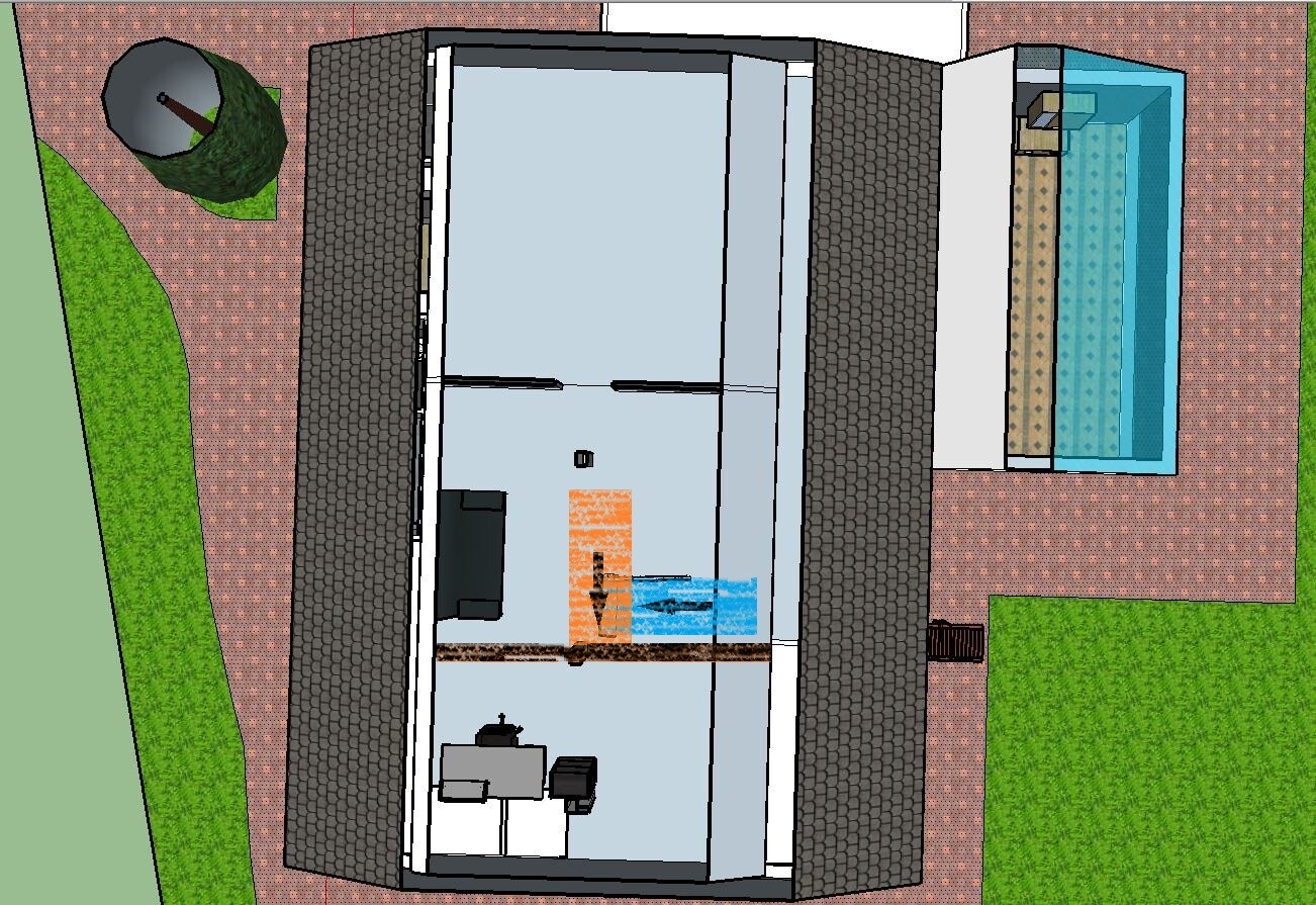

However, I see a difficulty with the attic exit.
Bottom left in white is the current hatch location, blue would be the planned variant on the wall towards the bedroom, orange your suggestion on the wall towards the hallway.
The plan is to build two rooms upstairs. If needed, two children’s rooms; otherwise, one children’s room and one guest or study room. I actually have to position the wall where the orange line is drawn; otherwise the room becomes too small. With the orange staircase exit, I wouldn’t have space left for access. Also, due to the lengthwise placement, a lot of standing height area would be wasted.
The upper wall already exists; the top third is the currently unfinished part.
So, I actually like this option best for the better flexibility on the ground floor, but I don’t think it’s feasible due to the mentioned issues. Maybe I’m just missing something.

The staircase spiral is on the other side. But probably the lower section can be adjusted, right?
Are you sure it was there and not along the load-bearing wall, meaning the center of the house?
I think it would fit better there since it wouldn’t block a window and is close to the room door.
You would also have a room divider to the living room/sofa for more privacy later when the kids are older.

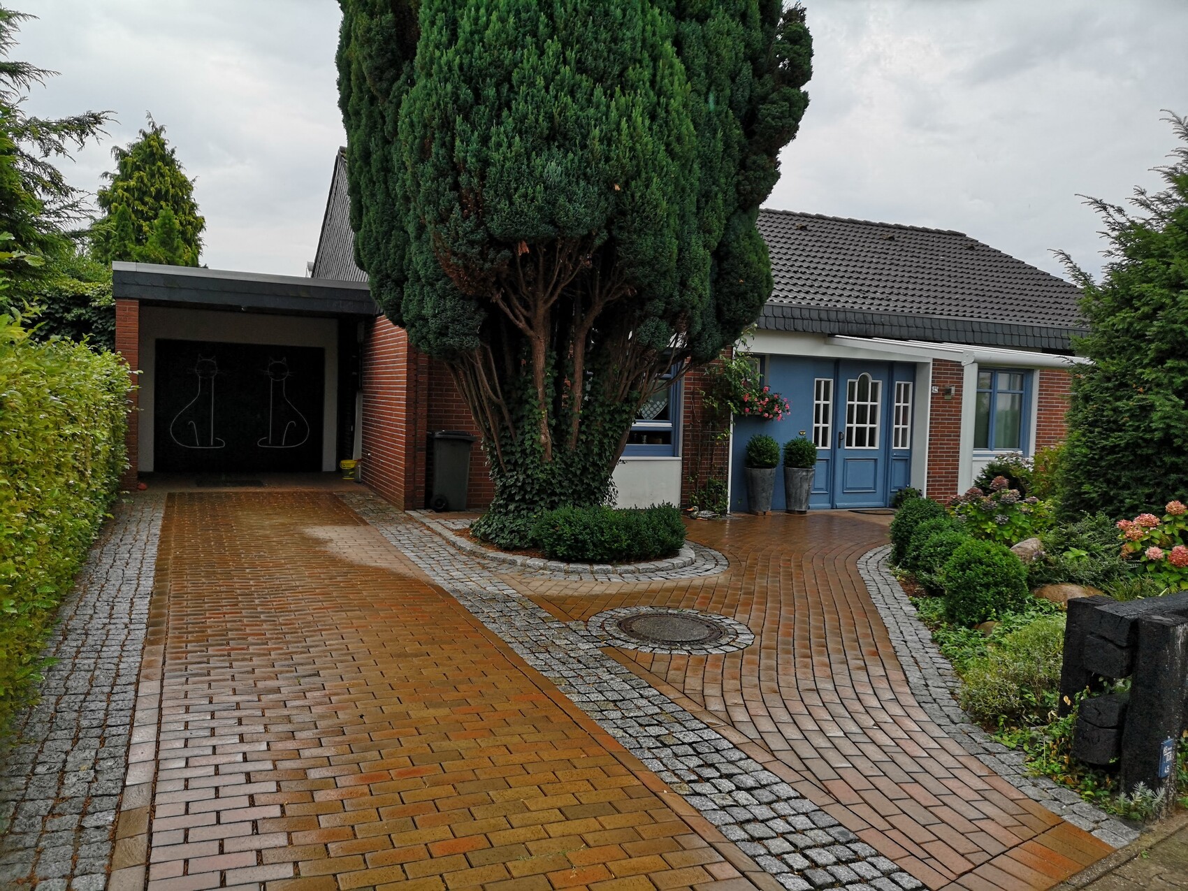

Do you have photos of the exterior?
I actually have pictures of almost everything. Are you interested in something specific?
