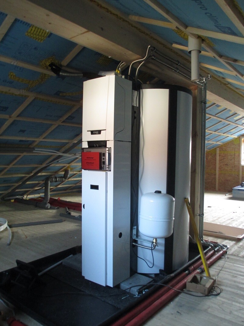

Username_wahl11 Sep 2016 23:06We have an insulated roof (additional cost around 2000 compared to an insulated ceiling), 25° pitch without a knee wall, a retractable attic ladder, and a simple wooden floor. We are very happy with this. The heating system with a buffer tank is installed there in a basin, and with 5 people, we have stored a lot of clutter that we don't want in the living area and wouldn't have had space for in the garage either, which is already full...

Username_wahl12 Sep 2016 21:05Gable roof. With a hip roof, it is hardly worth it. At the moment, there are boxes everywhere. Shelves will be difficult to install, and if at all, only low ones will fit. There are windows on both gable ends. The vapor barrier can be seen directly, followed by the insulation between the rafters made of Isofloc.
