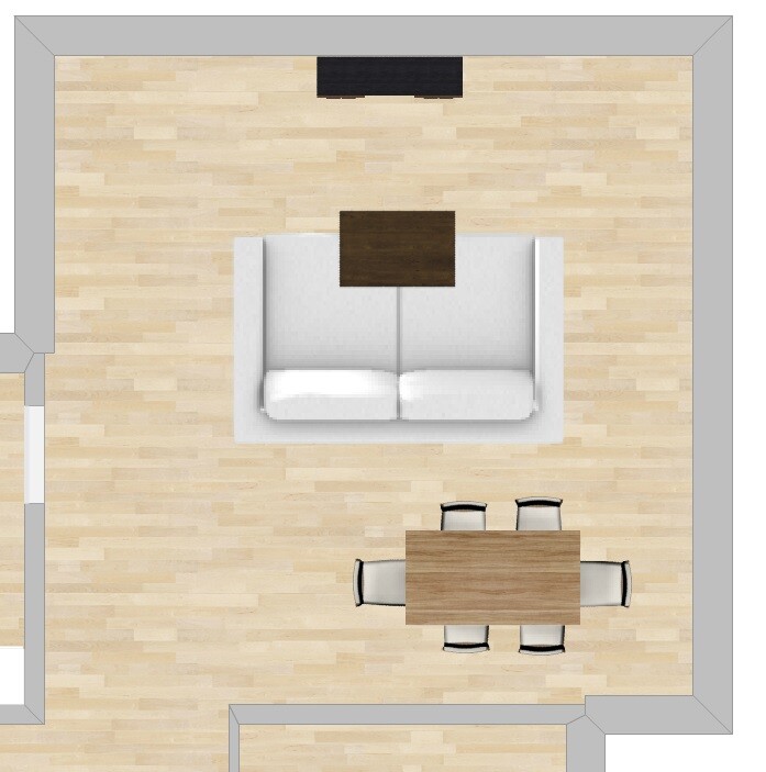

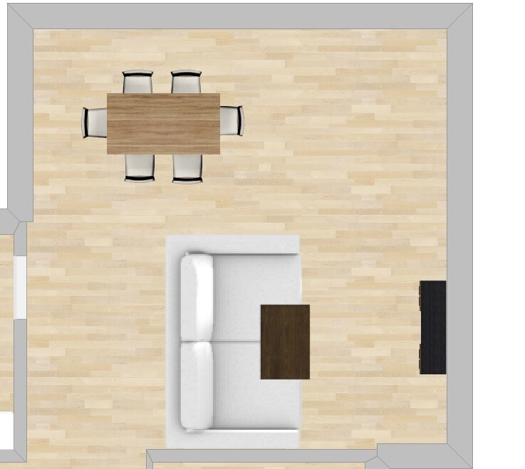

Sorry, this was done a bit hastily, but here is the basic idea:
Square (or nearly square) rooms are generally not ideal for dining and living areas, so some compromise is probably necessary.
Personally, I would go with one of the two layouts. In the first one, the dining table benefits from good natural light, and the U-shaped sofa layout allows you to enjoy the view through the corner window without awkward stretching.
The downside is that the double doors at the top of the plan are somewhat blocked by the dining table.
In the second layout, the sofa takes center stage and is well positioned for both the corner window and the TV.
The disadvantage is that the dining table ends up in a relatively dark corner.
I don’t really find either design perfect, but I would probably lean towards the second option.
