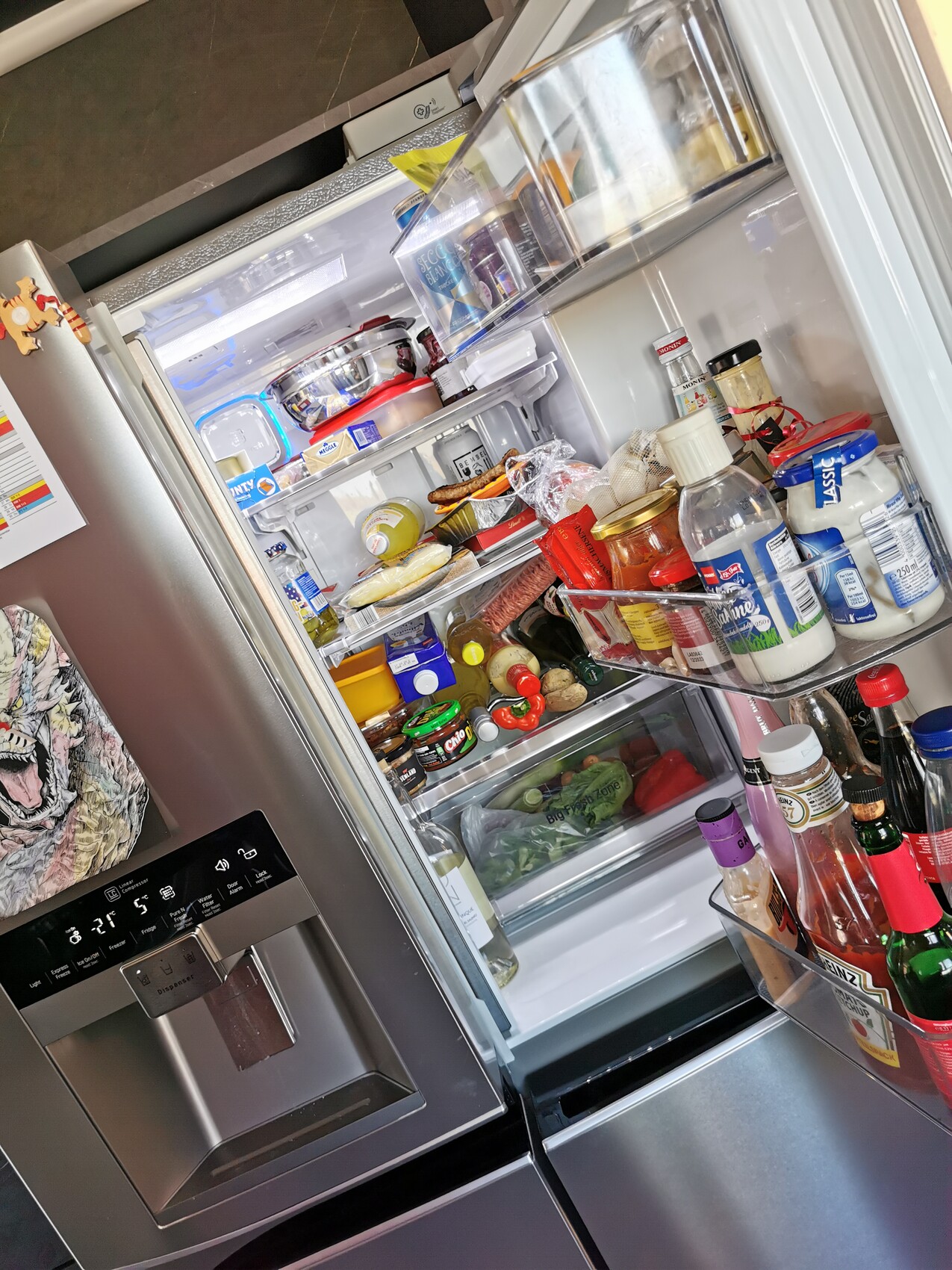

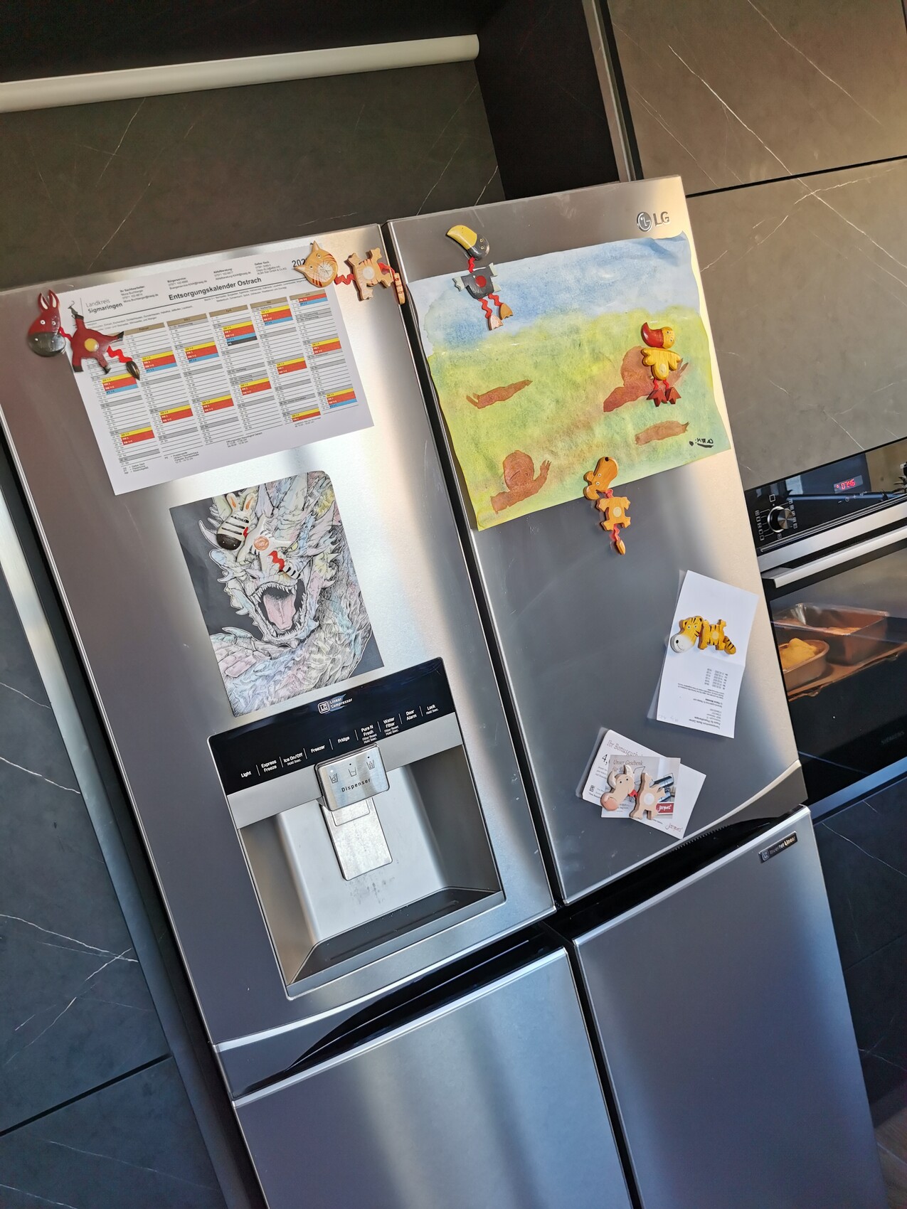

@Patricck ... but this is not the full integration that @Brakus71 had in mind. @Brakus71 .. the side photo actually illustrates quite well how deep the kitchen cabinets around a side-by-side refrigerator need to be if you want to recess the side-by-side refrigerator further. Unfortunately, you didn’t show whether your tall cabinet wall would then also end like this in the room.
The kitchen was designed around the refrigerator, which is placed freely in a separate niche.
The refrigerator was already there before the kitchen was installed and has its own water connection. I am not aware of any refrigerator that can be integrated as a side-by-side unit. For us, it fits perfectly into the kitchen.
If we recessed the refrigerator, the doors would no longer fully open, and this model does not have a dividing wall. The freezer section is at the bottom, the refrigerator above.
Brands like Haier, Bauknecht, AEG, etc. were all so disappointing in the showroom that we decided on the LG, and even after three years we are still very satisfied. The only issue was that a glass shelf took about six weeks to be delivered.
It does make some noise, especially if the door has been open for a longer time.
