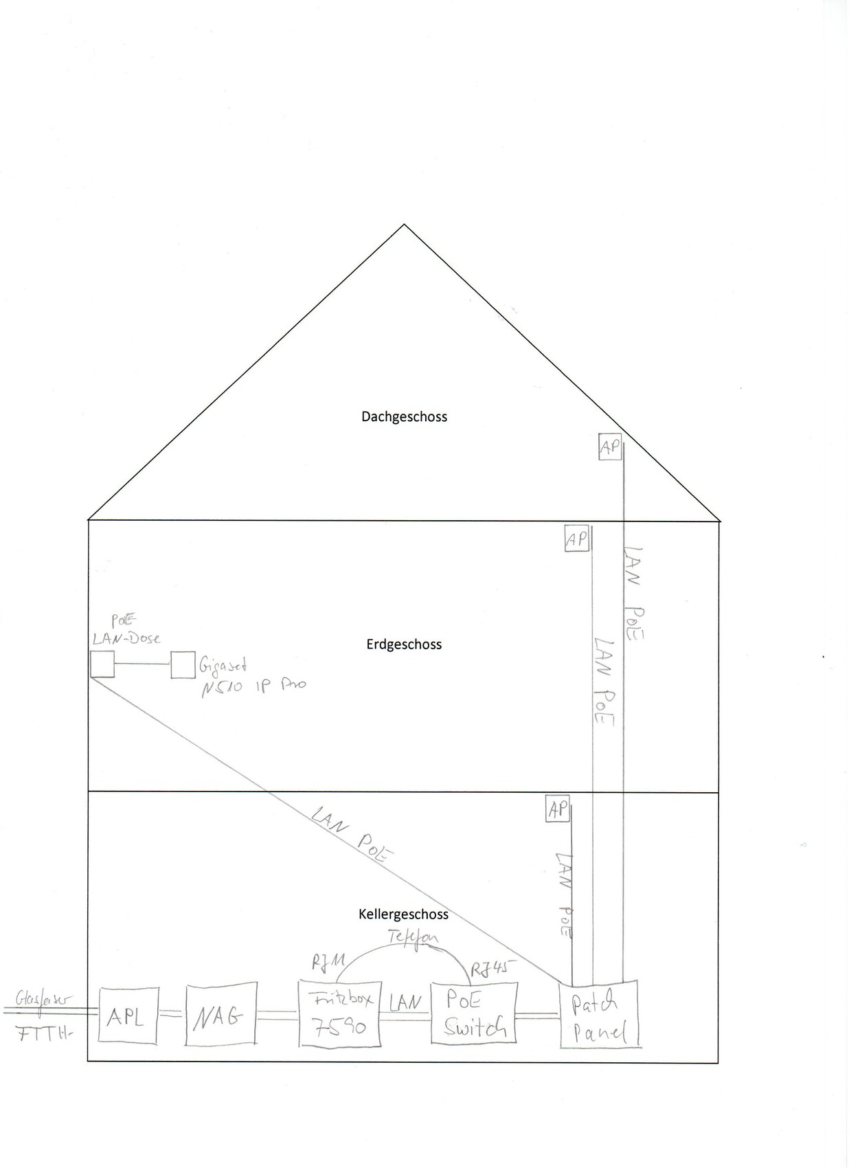

We will have fiber optic installed in our new home. The following is planned:
- One access point centrally mounted on the ceiling per floor
- DECT base station on the ground floor
I have sketched the wiring layout. Are my assumptions correct, or is there an error?
Additional question:
We will be receiving IPTV. Our provider offers a rental receiver for €4.90. Is it necessary to use this receiver, or can any other IPTV receiver work as well? LAN connections will of course be installed to each TV (not shown in the diagram).
Thank you very much for your help.

rick201813 May 2021 13:28
@untergasse43 is right. This is the only way it makes sense, and you will have fast Wi-Fi in the dining and living areas. Install a separate access point in the garage.
K1300S13 May 2021 17:51
This means the entrance area will be somewhat undercovered, but sometimes you have to make compromises. Otherwise, I would definitely recommend having a separate access point not only for the garage but also for the terrace.
untergasse4314 May 2021 09:57
K1300S schrieb:
This means the entrance area will be somewhat underserved, but there's no perfect solution. Otherwise, I would definitely use a separate access point not only for the garage but also for the terrace.
How often does one actually spend extended time in the entrance area and depend on excellent Wi-Fi there?
K1300S14 May 2021 09:59
I cannot answer that for the original poster, but in our own house, I am glad that I still have reception at and in front of the front door. Of course, other rooms can also be somewhat excluded, but that was not the goal here.
