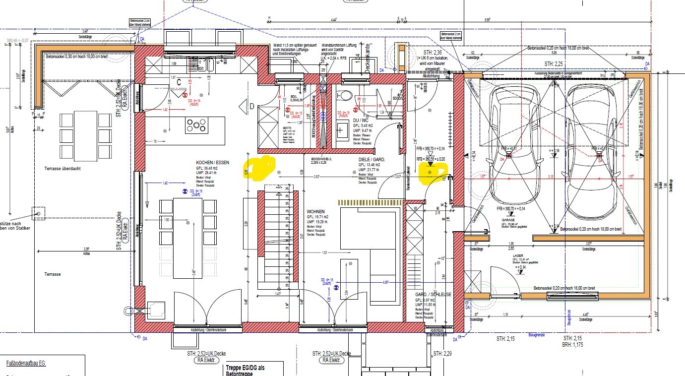

I now need to decide where to place the ceiling sockets for the access points (APs). In the basement, I would put one in the area labeled "Hallway." On the ground floor, I was thinking of having two APs: one in the entrance area to also cover the garage, and one in the hallway at the staircase to cover the terrace. Is that too many? Would one central AP in the hallway be enough? And is an AP even necessary in the basement, since the FritzBox is already located in the technical room?

K1300S13 May 2021 12:31
Based on our recent experience, we will have two access points on the ground floor with only a slightly larger area. I would probably do the same here, placing the second one at the staircase landing (leading upstairs). That should also cover the terrace.
chamäleon
13 May 2021 12:43
Like this, marked here in yellow?
Floor plan of a house with kitchen, dining room, living area, hallway, bathroom, double garage, and terrace.
K1300S13 May 2021 12:45
No, for me that is the exit (from the basement stairs). I wrote
K1300S schrieb:
about the stair landing (upstairs)
That referred to the stairs to the upper floor, otherwise the two work phases overlap too much.

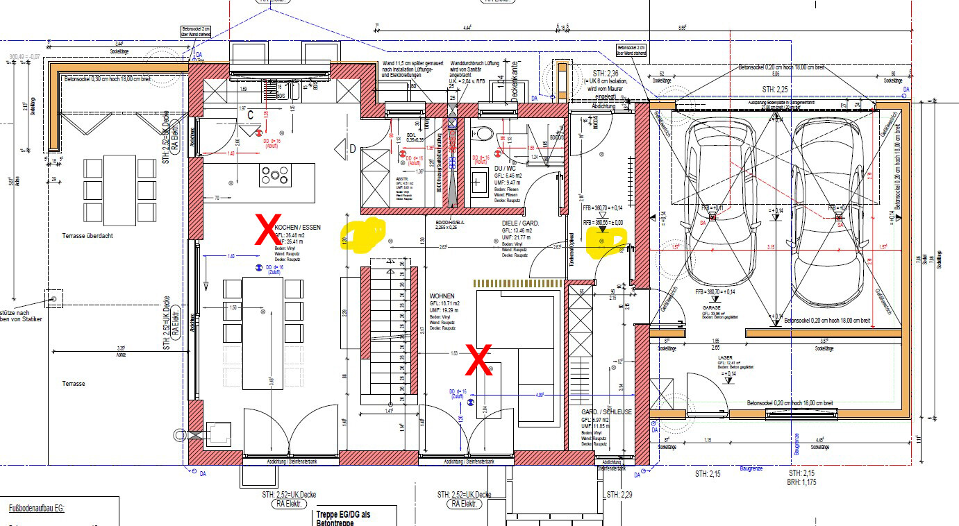

untergasse4313 May 2021 13:01
More like this... and if you need Wi-Fi in the garage, I would install a separate access point there. The wall to the garage should be solid, after all.
