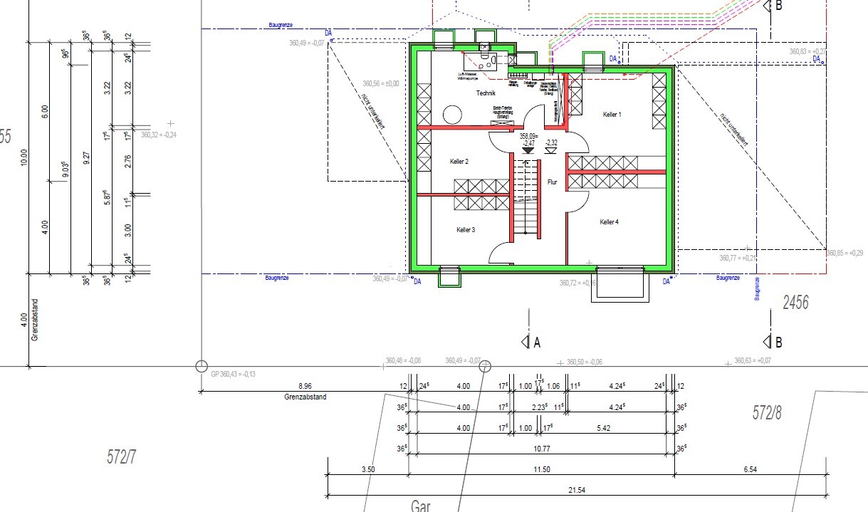

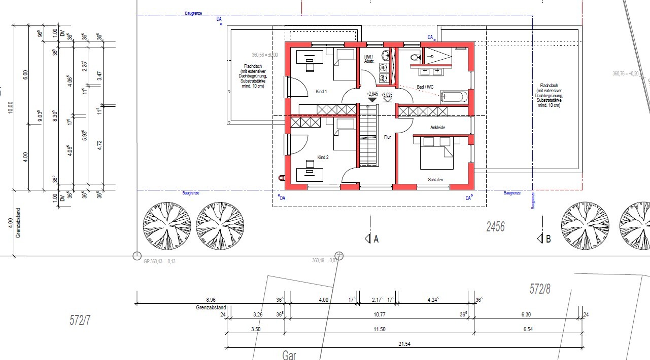

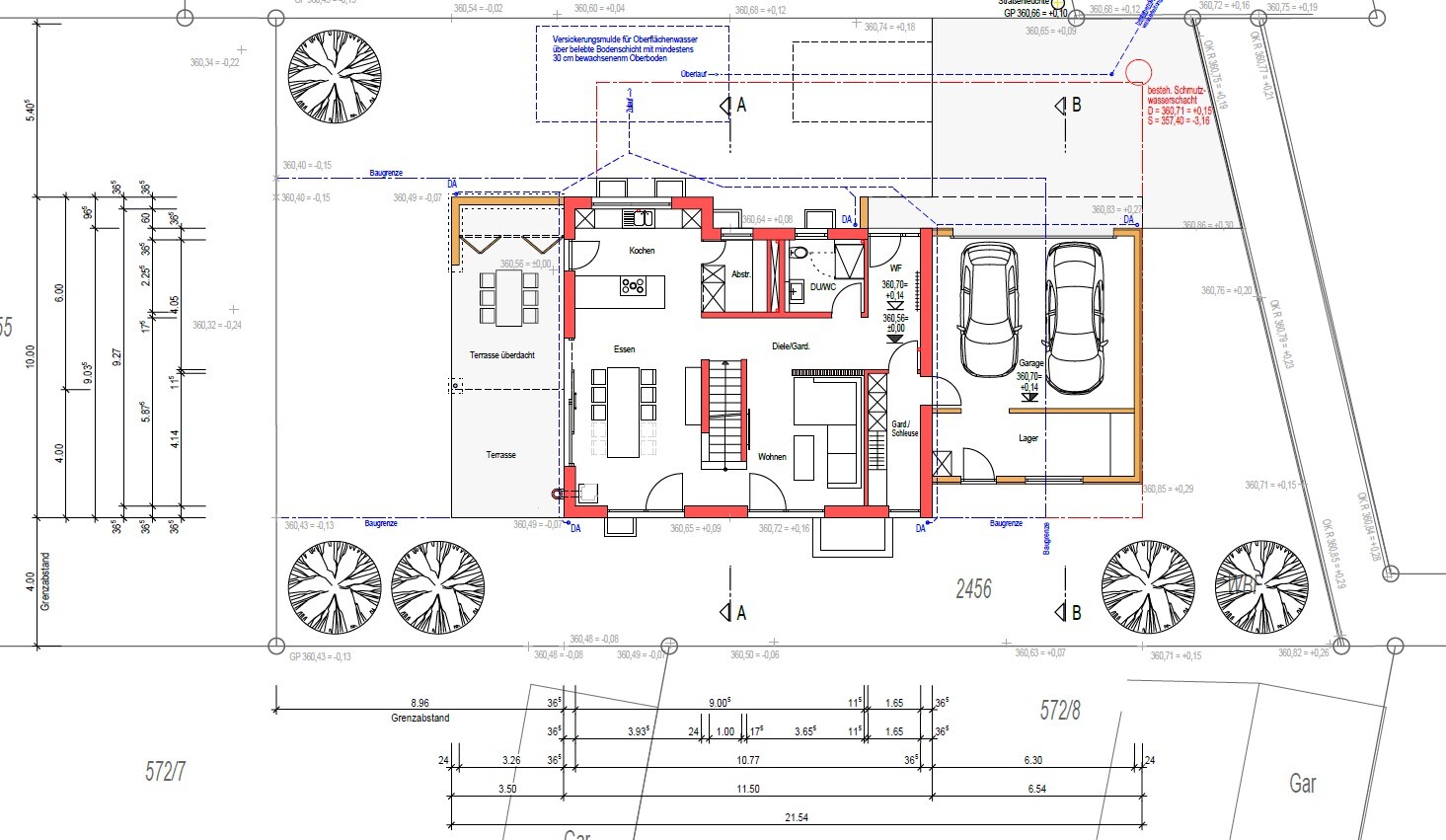

We will have fiber optic installed in our new home. The following is planned:
- One access point centrally mounted on the ceiling per floor
- DECT base station on the ground floor
I have sketched the wiring layout. Are my assumptions correct, or is there an error?
Additional question:
We will be receiving IPTV. Our provider offers a rental receiver for €4.90. Is it necessary to use this receiver, or can any other IPTV receiver work as well? LAN connections will of course be installed to each TV (not shown in the diagram).
Thank you very much for your help.

However, the N510 IP Pro DECT base does not have an RJ11 port. It connects via LAN. So I thought I need to bring the phone signal from the FritzBox into the network using the RJ11/RJ45 cable and then pick it up again on the ground floor. What would be the correct procedure to connect the DECT base on the ground floor? IP phones (including the mentioned DECT bases) have absolutely NOTHING to do with traditional phone signals or telephone ports. Everything runs entirely over the LAN. In the FritzBox, you simply configure it as an IP phone and you are good to go. Forget about the phone port on the FritzBox completely—these days it’s only needed for a fax, and even then it’s better to use an external ATA.

chamäleon13 Apr 2021 20:55C
chamäleon13 Apr 2021 21:13untergasse43 schrieb:
IP phones (including the mentioned DECT bases) have absolutely NOTHING to do with any telephone signals or telephone lines. Everything runs entirely over the LAN. In the FritzBox, you simply set it up as an IP phone and you’re good to go. Forget about the telephone line on the FritzBox completely; nowadays, only a fax might still need it, and even then it’s better to use an external ATA. Thanks for the information. I had misunderstood. Only if I want to bring the analog signal to a specific network outlet, then I connect the FritzBox directly to the patch panel with an RJ11/RJ45 cable and can then connect the analog phone to the corresponding outlet. Is that correct?
Otherwise, as you wrote, just plug it in and you’re good to go.
