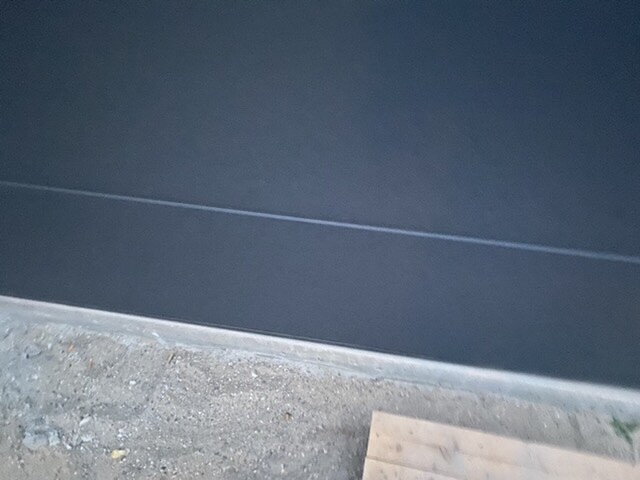

the next project is coming up: tiling the garage.
The tile installer and I have already applied the leveling compound.
The plan was to start tiling on Saturday.

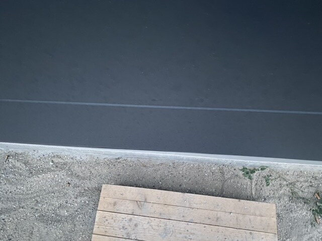

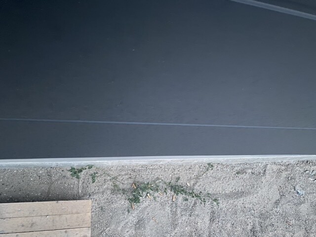

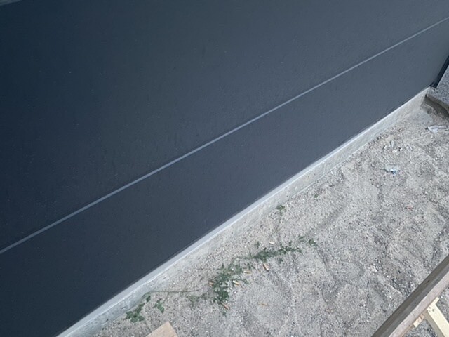

Today, I noticed for the first time that the slab at the front is curved.
The garage door is 4.50 m (15 feet) wide. The slab ends fairly flush with the door on both the left and right sides. Not exactly, but near the middle the slab protrudes almost 2 cm (0.8 inches).
What could be done to straighten the slab here?

Coletrickle_780820 Jun 2022 04:43Saw off. 2cm (0.8 inches) should not affect the existing overlap. Landscape gardeners often use a "moped" — a petrol-powered stone saw (a sort of large angle grinder).
The question might also be how to design the transition between the outside (paving?) and the inside (tiles). If there is a sufficiently wide transition strip (a small floor threshold with a seal under the gate), this might not be necessary.
Coletrickle_780820 Jun 2022 08:01I took some measurements this morning. It is exactly 1.5cm (0.6 inches). It certainly looks like the formwork board was pushed outward there.
The front will be finished with a stainless steel T-profile. At the top, it has 10mm (0.4 inches) and is flush with the tiles. At the bottom, it measures 65mm (2.6 inches) and creates a clean edge. In the end, it needs to be straight; otherwise, it will look uneven.
The area next to the garage will be paved, but about 1cm (0.4 inches) lower to prevent water from flowing in.
