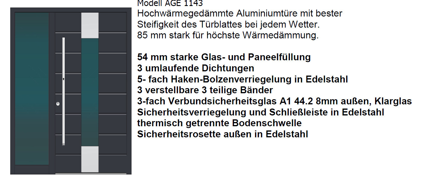

@merlin83 The Inotherm site does indeed look very interesting! But am I reading it correctly that they don’t install a motorized lock, but rather an electric door opener? No, that is not correct. They install a fully functional motorized lock that fully secures the door every time it is closed. When opened mechanically, it is then completely unlocked again.
Our fingerprint reader is integrated into the handle. If you don’t like the door as shown in the standard models, they make almost any modifications upon request.
Attached is a photo of our door, which cost a total of EUR 5,400 (powder-coated in DB703).

Regarding comparing door prices, this only works for doors that are exactly the same size with identical features; anything else is like showing pictures of different cars and listing prices alongside them.
On the contrary, the self-locking locks I know are all mechanical; the so-called electric strike is only added when a motorized function is desired.
However, there are also fully motorized locks.
But I’m not talking about doors that simply close mechanically. I’m referring to a door where a motor electromechanically locks it every time. In the picture, you can see that it is a door with a side panel. Anyone can see that the door is not 4 meters (13 feet) high and wide – a 10 cm (4 inches) difference doesn’t significantly affect the price.
