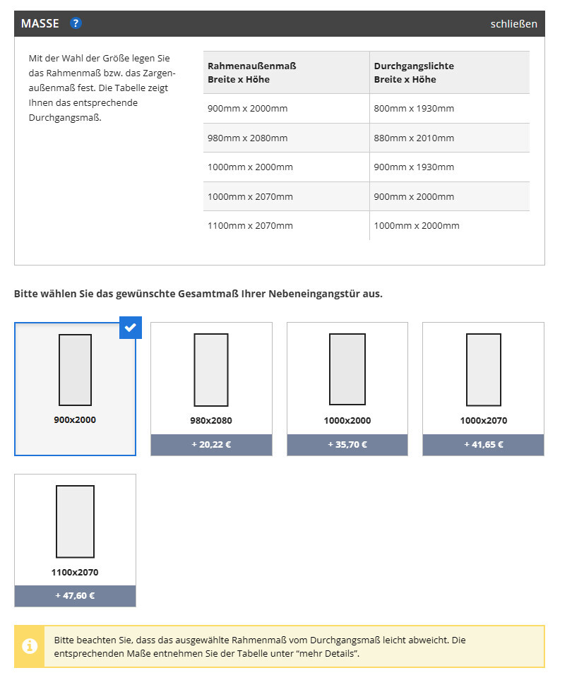

The former can be purchased inexpensively at most hardware stores in various standard sizes. Check the available options and then build the wall to fit the door. Alternatively, you can customize it through various online retailers.
For example, use the configurator with additional information on the required rough opening dimensions:

Is the room’s external dimension the distance between the reveals, or is that the external width of the door and I need to add something to it? You need to check the rough opening—the required aperture—which is specified by every supplier. The room’s external dimension is not helpful.

I’m considering the Meeth plastic front door Signum PVC 32. It costs only €399 at the hardware store for a width of 110cm (43 inches).
On another site, the rough opening size for this door is listed as 112cm (44 inches), so about 1–2 cm (0.4–0.8 inches) allowance on each side. With the current garden shed width, I am unfortunately 6cm (2.4 inches) too short. What is the best way to make up for this?
