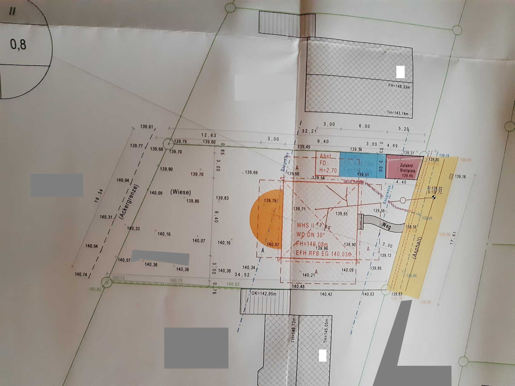

ᐅ From which point is the 5.50-meter distance between the garage and the street measured?
Created on: 10 Aug 2022 18:46
Pinkiponk
We have decided to forgo the carport (see photo) and instead install a prefabricated garage. The street runs at an angle. According to the development plan (see pink marking in the photo excerpt), a distance of 5.50 meters (18 feet) must be maintained between the street and the garage. Does anyone know if this 5.50-meter (18 feet) clearance to the garage is measured along the longest side (i.e., the boundary with the neighbor) or the shortest side? Or must the 5.50-meter (18 feet) distance be maintained along the entire length of the street frontage?
My husband thinks that since the street is angled, he can choose where to measure the distance (he’s a technician; he believes in physical laws but not in administrative regulations) 🙂 but he doesn’t want me to call the building authority to confirm. ;-) Now I’m worried that if the garage (built on the expensive concrete slab) is in place, we might have to dismantle everything again if we only keep the 5.50-meter (18 feet) distance on the longer side.
Thank you very much for your help.
