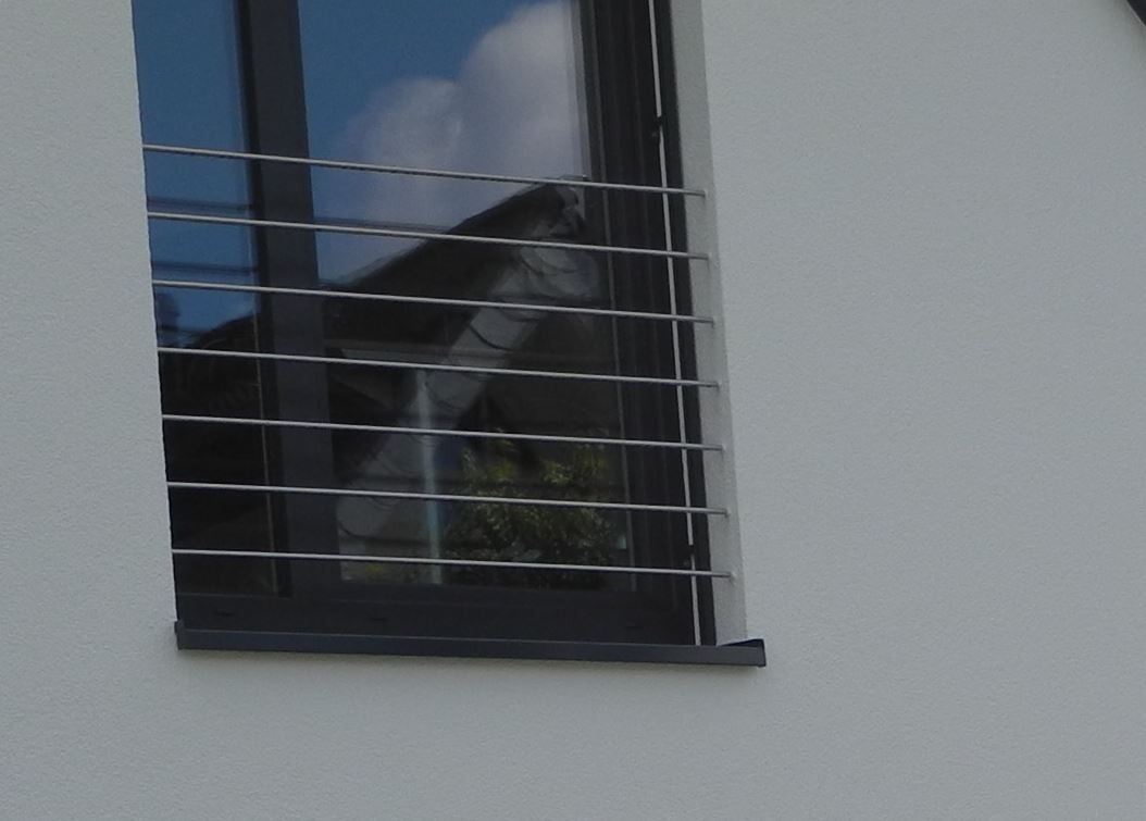

It is also possible to anchor the railing bars of French balconies into the facade, but then integrate them into the external thermal insulation composite system (ETICS); this looks very subtle and unobtrusive:
Window of a white building with horizontal metal bars as grille; reflection of sky.
11ant28 Apr 2021 23:48
MM1506zzzz schrieb:
You can also anchor the balustrade bars of the French balconies into the façade, but then work them into the ETICS; it looks very subtle and unobtrusive:
... you forgot "labor-intensive" ;-)
